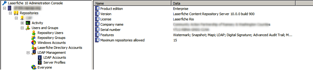

replied on December 14, 2015
Is the LF server licensed correctly? If you open the admin console, select the "servername" node, the right hand pane should show a summary of the licenses available.  Does it show the correct number and does it show the server as licensed?
Thank you.  Highlighting the server instance in the console, it lists our server version and products.  No # of users listed there.  This is the screen shot.  Would it be useful to remove the LFserver10 from the machine and reinstall?
I'm almost thinking the right fingerprint was registered.  I'm stumped.

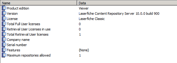

Your screenshot indicates that LFS is unable to load the license, that the license is invalid, or that LFS cannot confirm the license validity with LFDS.
The three scenarios I can think of are:
  1. There is a fingerprint mismatch between the license from LFDS and the machine
  2. LFS on this machine cannot reach LFDS to confirm that it is licensed
  3. The license file was for a different product
Try checking the LFS event viewer now that you have relicensed the server and see what the license error is. You could also check the LFDS event viewer in case there is an issue on the LFDS side.
To check (1), you can view the hardware fingerprint in the license file and run showhwfp.exe on the LFS machine to see if they match. For easier reading of the license, I recommend using either a program like Visual Studio that can read XML well, or an online XML formatter.
I'm not sure what the best way to check (2) is; perhaps Support has some suggestions.
To check (3), read the license file and see if it says Laserfiche Server.

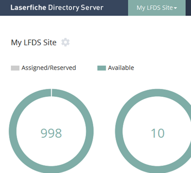

If you are encountering a [9010] error and the stated workaround did not help, you may be running into an issue where the "legacy name" of the LFDS database doesn't match the current display name.
To check whether this is the issue, run the following SQL command:
SELECT *
  FROM [yourDBname].[dbo].[db_settings]
  where name = 'legacyName'
Replacing “yourDBName” with their LFDS SQL database name.
Then, compare that value to what is shown in the LFDS UI:
If the two do not match, you have have two options to fix this (option 2 requires more work; I strongly recommend option 1)
  1. Change the display name to match the legacy name
    1. Detach the site, make sure to leave “Delete SQL db” UNCHECKED
    2. Reattach the site, and use the legacy name when asked for the display name
  2. Change the legacy name to match the display name
    1. Run the following SQL query (replacing yourSQLdbname and yourSiteDisplayName)
      USE [yourSQLdbname]
      GO
      UPDATE [dbo].[db_settings]
         SET [value] = 'yourSiteDisplayName'
      GO
    2. Detach and reattach the site, using the same display name. This step re-loads the legacy name into an encrypted LFDS config file.
    3. Reissue licenses to all applications that use SSO and/or check back for licensing
      1. Even if not using SSO, replace LFS and Quick Fields licenses
      2. If you are using SSO, replace Web Access, Forms, Mobile, and Social BPM licenses

This is exactly what we are experiencing right now.  Out of the blue.  Two days ago everyone could connect and after that, some people can connect some of the time.
Ironically, I started this thread last year and things were eventually resolved.  Now I do not know what is preventing access.  I have also tried using the ADMIN account as well with sporadic results.  We are either of these:
Error 784 -- Operation Timed Out (detail below)
Error 797 -- Could not connect to the Laserfiche Server (detail below)
HTTP operation has timed out  (when trying to access WebAdmin)
We are racking our brain to figure it out.  We tried both the machine name and the IP address in the "Attach" section.  Nothing seems to work.  Our LFDS is on one VM and our server is located on another VM.
I have regenerated our license for our server and refreshed the master license.  No luck.
I think it has something to do with the connection timing out.  I looked in the registry for the LFSO entry, but there isn't an LFSO entry there in both the 32bit and 64bit sections.
Help!  This really is puzzling.
