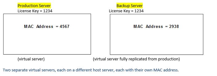

Client has a Production server and a mirrored Backup DR server that is exactly the same EXCEPT for the MAC address. The License keys are the same as well.
To reiterate, These are two separate virtual servers, each on a different host server, each with their own MAC address. See the picture below.
The user is aware that in order to perform their DR they do twice a year, she will need to manually deactivate the license key and generate a new license for the backup server. So now the production and the backup will have different license keys. (referencing https://answers.laserfiche.com/questions/71848/Invalidating-the-Hardware-Finger-Print--Replication-and-Disaster-Recovery )
The question: If this action is performed, what affect will it have on the production server?  Obviously, we are hoping there is no affect on the production server and it will continue to run seamlessly.
Let me know if any more clarity is needed.

Brianna,  I am the client Corey is working with on this DR scenario.  We are using the Laserfiche Directory Server (Rio License Manager).  We are Rio 10 currently, but upgrading to Rio 10.1 this afternoon.
We replicate the Laserfiche server which houses our installation of LF10, WF10, Forms10, Web Access 10 and Social BPM  and our SQL server to our DR site in real time.
We will cut replication as of 8am day of the test and bring up the Laserfiche and SQL servers at the DR site.  Per the documentation in the above referenced Answers post, it looks like I need a separate license for my DR virtual.
What I'm looking for is best practice for DR in the virtual environment.  Please advise.
