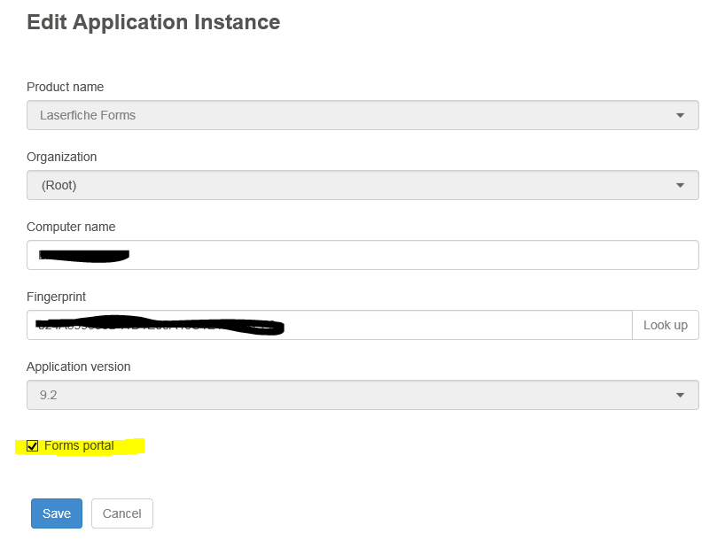

You will need to re-register the instance for forms and then select Forms Portal option in the instance.  If you are using LFDS, then you can open the instance to add Forms portal to the instance, and then re-generate the lf.licx for forms.
replied on October 28, 2015
The option to check Forms Portal is not there.
