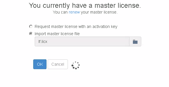

I did a manual deactivation and an activation to obtain the lf.licx file.  When i try to load it into via the LFDS interface, the status icon keeps spinning with no results.  The reason why i had to go through a manual deactivation/activation is because the client is unable to open the required port for laserfiche to renew automatically.

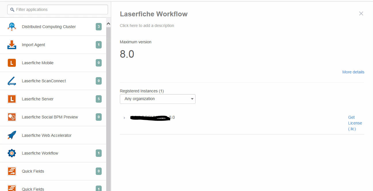

Alex,
I just did an unregister but it still doesn't want to load the master license.  I do notice that they have a workflow instance registered for version 8.  Should this be removed as well?  Also, they do not have any Web Accelerator registered.
replied on October 1, 2015
Go ahead and proceed with removing the registered Workflow 8.0 instance as well. Another potential application that may have an issue is WebLink, so please keep that in mind. Once you are able to successfully renew the master license, just add back the needed application instances.
