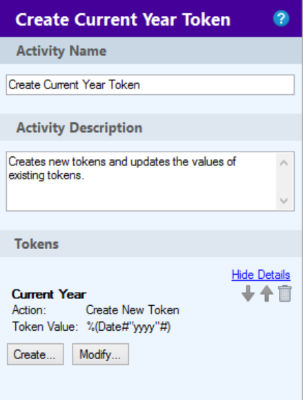

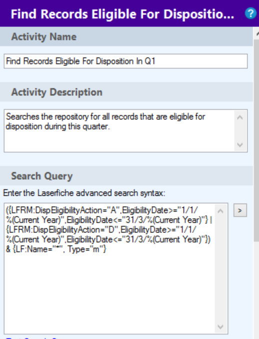

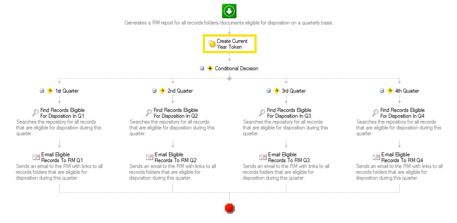

I'm in the process of implementing RME for a client. I want to include a workflow that will run on the first day of each quarter of the year. The workflow will automatically send a report of all records eligible for disposition during that quarter. Please see the attached screenshot of the workflow I have built up to this point. I create a token to extract the current year, then run a search for all records eligible for disposition (accession & destruction) during the upcoming quarter.
I want to send those search results to the Records Manager in an email via document links. How do I attach all those links to the email. I'm thinking I need a For Each Entry activity to iterate through all the search results, but if I include the email activity in the For Each Entry, it's going to send an email for each search result. How do I send just one email with all the links attached?

You shouldn't need the branches if you use a scheduled Workflow that starts every 3 months (ie, at the beginning of the quarter). You can use the current date and subtract 3 months to get the other end of the quarter and use the values in the search.

Workflow does not currently have a way to add multiple document links in Email (due to the possibility of a large number or search results).

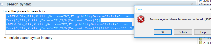

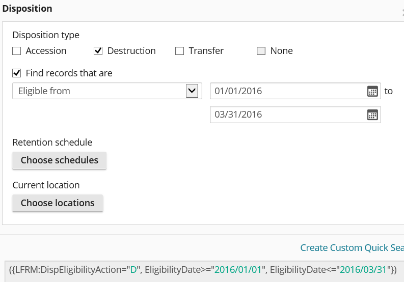

I see that you still have the '%(Current Year)' token in your search query. That token is only available in WF, not Client, where you're running this search. In Client, you would have to replace the words '%(Current Year)' with a real year, like '2016'.

replied on September 2, 2016
How did you come up with your Records Search?
I typed out exactly what you have above and I get this error message:
And if I try to duplicate it in Web Access 10, all I can get is this:

One tip I can give is to first run the search in Client to make sure it works properly, then copy/paste the advanced search syntax into the WF activity. If the search doesn't work in Client, then attend a CFW to troubleshoot.

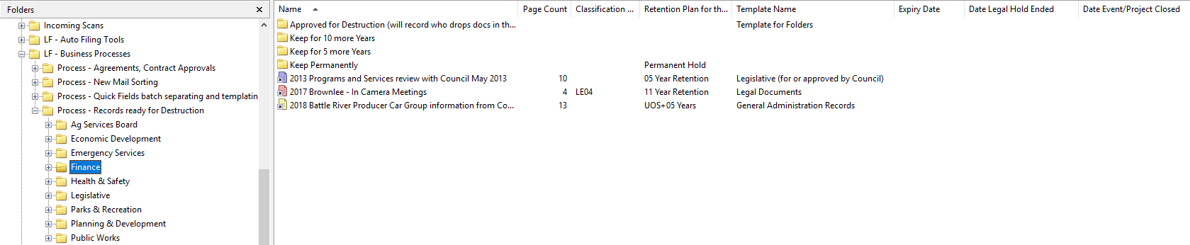

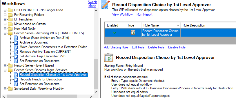

Bruce, I would also love to hear from Nareg to see what he's done.  For my own processes, I chose to have my workflow put the records "shortcuts" into a temporary holding folder instead of emailing them to people, folders set up per department for our staff to review and approve for destruction via moving the shortcuts into folders that indicate their desire for each of the records they need to review.  Another workflow records who dropped any into the Approved for Destruction folder (this is the first level approval).  Once they have completed sorting and making decisions, the names of those dropped into the destruction folder get exported onto an Excel spreadsheet "Destruction Certificate" which gets signed by the department head and the CAO, which then gets scanned back into Laserfiche as our final record of destruction.
I just threw a few shortcuts into a blank folder here as examples to show you a bit of the sorting they can do.  Most of the columns that will be used to check metadata (as shown above) are newly developed procedures so most of the older documents (shortcuts) that will come into these folders will not include anything in these columns, but in future years these columns will give great clues as to what may be deleted or what needs to be checked out further (our repository is only five years old).  I find it's the event based retentions that most often were ending up in retention folders too soon.  I have added my summary of the tools I've set up for event based retention controls, as well, in case that is helpful.

Connie, great info!  We're planning on using the search then create shortcuts to review folders/records by Dept. also.  Your documentation is very helpful - I'll look at everything closely, and respond back with questions.  Thanks for jumping into the discussion!

1) A workflow is monitoring this folder and adds the User name to an Approved by field that users are not allowed to modify.
2) The Original File Path is recorded by the workflow that does my mass archive on Dec 31st each year.  (See attached document that outlines what my retention and "archive" workflows do and what I mean by "archive".)
3) The Disposition Choice is another workflow monitoring these folders.

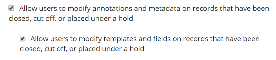

Connie, see PRD147 page 10 from Justin Pava.  Talking about upcoming 10.4.1 (soon...!)Here:https://support.laserfiche.com/resources/3998/prd147-simplify-compliance-with-new-flexible-records-management
With 10.4.1, we'll be able to modify fields AFTER records are cutoff.  Opens up a lot of possibilities.  Then you'll be able to do what you describe above.  In the meantime, I'm working on a customer demo to show the approval-before-destruction step, and it's going to need to be mostly manual.  Maybe somebody with another perspective on a solution will add here (Miruna...??)  I appreciate your good documentation and useful concepts I can incorporate in my solution! Thanks!

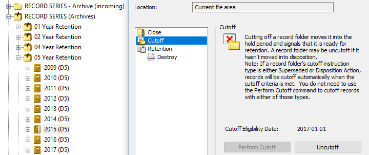

Sorry, the correct terminology is "Uncutoff".  I've had to do this numerous times when someone wants to add pages to a record because there has been addition information on the topic of the entry.

I looked at the WF "Set Records Management Properties" and don't see a way to uncutoff using a workflow routine.  Wondering if there's a way that once the docs ready for Destruction are sent to the Dept. Approval folders then they could all be uncutoff so the template fields would be available for use during the approval process?  Not looking possible.  Would be a pain to do without automation.
replied on March 21, 2019
That would be good if it could be done.  I was thinking I would have to do it manually.
