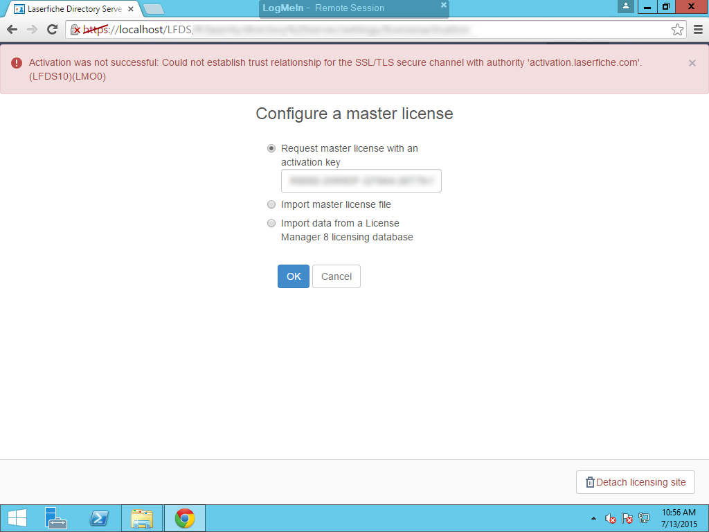

Receiving the following error when trying to activate the master license for a Rio 9.2.1 install

Similar to License Manager 8.3, Directory Server needs to be able to contact the Laserfiche activation server to perform an activation from a key. This previous post on the topic has some suggestions for how to handle this issue, as does this post. Your options are to make firewall exceptions (one for activation.laserfiche.com on port 443 and one for the GoDaddy Certificate Revocation IP), or to activate the license from a machine that has a less strict firewall, as described in KB1012198
Edit: it's been brought to my attention that newer Windows machines (8.1, Server 2012r2) may not have GoDaddy as a trusted root certificate authority, which would also cause issues with the SSL connection.

There are cases where outbound traffic on these ports are blocked (very high security networks), or the firewall is stateless and thus inbound traffic must be specifically allowed.
Regardless, it seems the recent issues with connecting to the activation server are more likely due to the GoDaddy certificate not being trusted, as Miruna mentioned here and I described in my edit.
replied on July 13, 2015
All suggested ports were open - we ended up having to activate the license from one of our local workstations, and then import the .licx license file on the actual Rio Directory Server.
