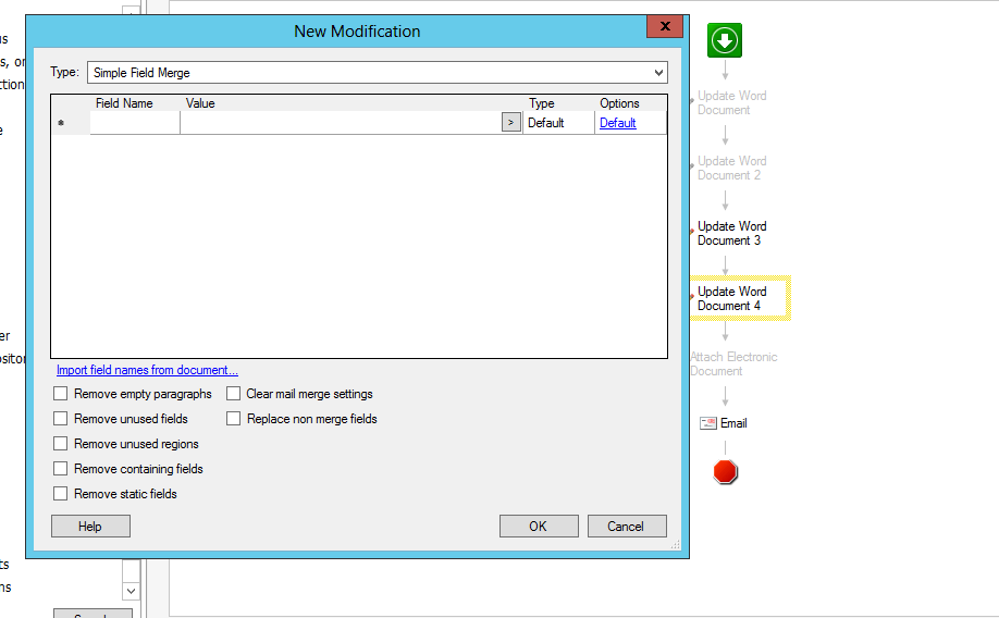

Currently we are not able to find variable of checkbox in "Update word document" ; so please help me out for the same.
Also when we import from activity ; we are not able to search any fields within word document. (see Blank Field Name.png )

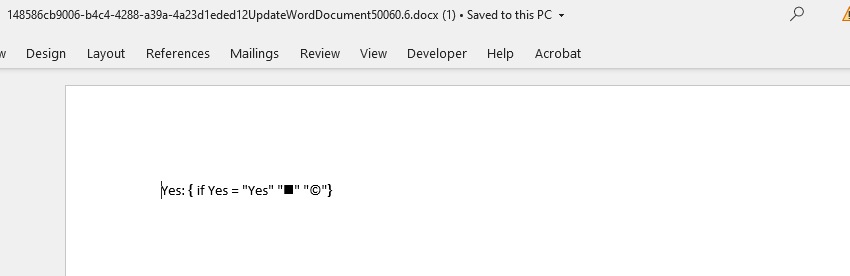

You need to use a merge field in order for the field to show up in the Update word componet, it is very particular in that.
In your specfic use case ( radio buttons / check boxes) you need to use a conditional Merge Field.
Below is the one I used to create the output from Laserfiche Cloud Workflow using the Update Word workflow task with a Laserfiche form Input.
Be mindful, that just typing it out in word will not do.. You need to use the CTRL+F9 to create the outter conditonal brackets and then build your if statement with a merge field (Insert>QuickParts>MergeField) then insert your symbols (I find Windgings work best) into the Yes and No sections like above.
Remember to exit out of the design mode (ALT+F9) and save the word doc before uploading to LF Workflow.

replied on March 4, 2022
Please find the attached file which , I have created and here  "%(Yes A)" is my LF variable name.
But still it shows nothing ; so please help me.
s3.docx (11.58 KB)

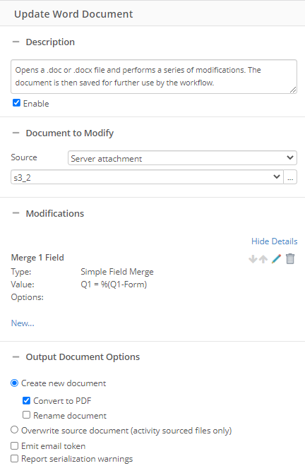

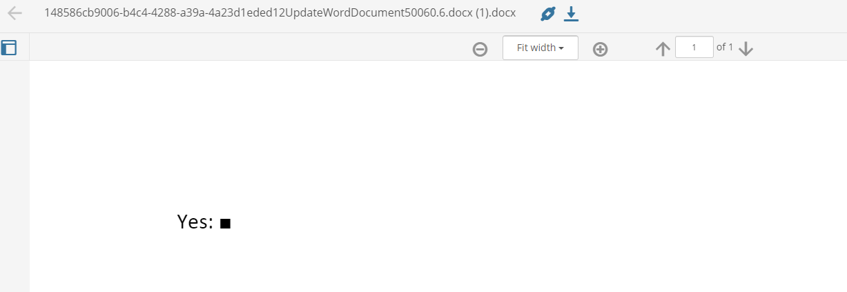

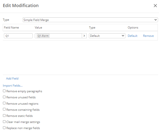

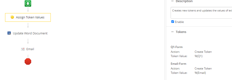

Hi Pratik,
I think the % or () is what is breaking this for you.
I took your word doc (S3_1.docx Attached) and changed the %(Yes A) to Yes and it worked for me.
I then changed the symbol to something different (S3_2.docx Attached) and that worked as well.
Attached is the PDF output from the workflow. S3_2.pdf
Are you using Cloud or On Prem?
Also here is the screenshots you requested as well.
WF Overview:
Update Word Componet:
Merge Field Configuration:
Thanks for solution and support.
But for when we "Convert to PDF" it works fine but when we not select that options its shows word file without proper output. ( see word file output.png )
Also attached generated word file for your reference.
Thanks,
Pratik
Hi Pratik,
When I open the word doc above it displays properly.
Maybe your word is in design mode. Select ALT+F9 again and try it again.
I unchecked generate PDF my configuration and tested and it works as expected.
Does it work for you?
https://portal.laserfiche.com/f6288/forms/WC
replied on March 5, 2022
Yes it works for me. Thanks for support and your time.
