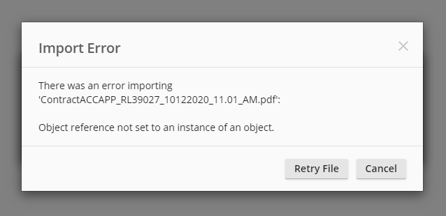

Here is what the errors caused by this bug look like:
Error messages on import into the Laserfiche Repository (or Web Access):
Import Error
There was an error importing 'Document.pdf':
Object reference not set to an instance of an object.

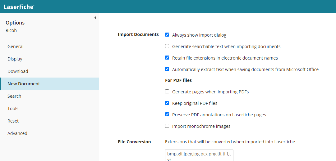

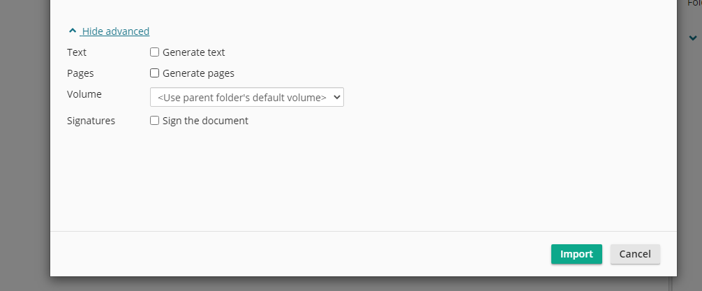

So, for Web Access and/or the Windows Client (e.g. Drag and Drop) - simply deselect "Generate text" and "Generate pages" after dragging and dropping into the repository on import.
You can find these settings here:
The default options on this screen can be accessed via your User Profile which you can find here:
Specifically of interest will be the "New Documents" tab which displays your Import Defaults:
You want to set your default settings here to make your own life easier.
Failure to do so in Web Access / Windows Client will result in this error when importing malformed DocuSign PDFs:

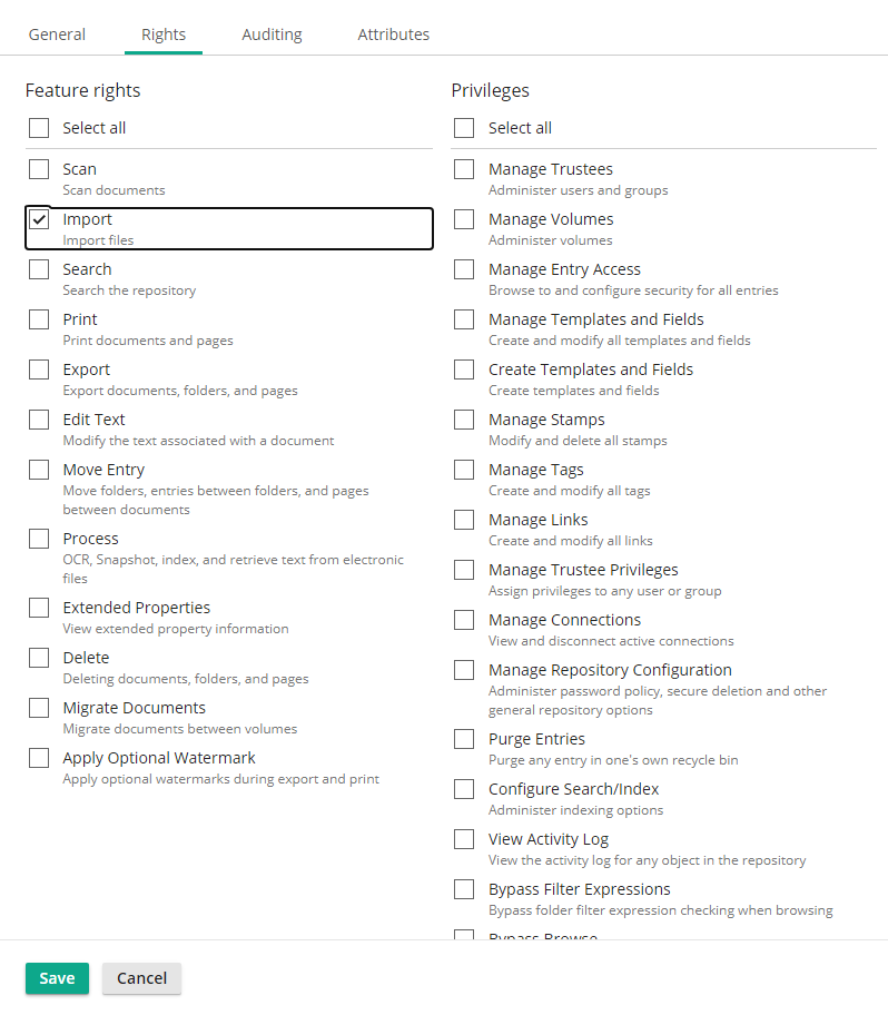

Generate a strong password, and keep a record of it in your preferred Password Management solution. For this service user, be sure to ignore the maximum password age and to prevent the user from changing their password.
It is best practice to only provide the user with the privileges they need, in this case their sole purpose is the importing of documents to the repository.

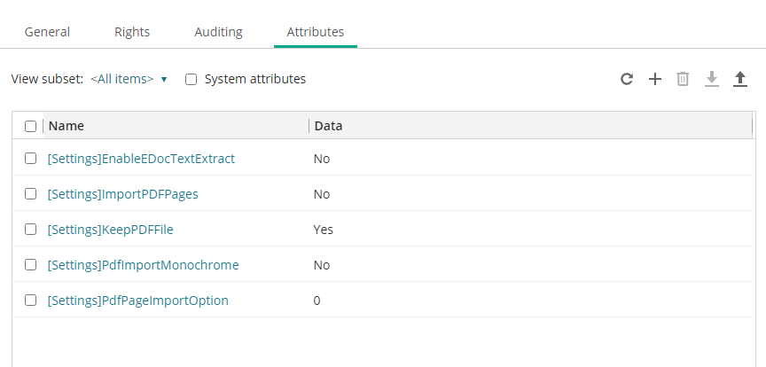

Now, if your environment is like ours chances are you've got authentication connected to Active Directory which means you may not be able to login as the user and access their options to set the defaults without a whole lot of fuss.
Luckily, Laserfiche allows you to manually set preferences at the user profile level. So, using the attributes outlined above, configure our "Filing Clerks" user attributes using the "Attributes" tab. This will set the defaults to ensure your PDFs do not have their text or pages processed when they're passed into the repository by the "Save to Repository" activity in Laserfiche Forms.

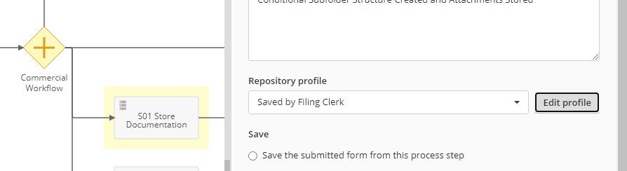

The last step is to update your Save to Repository Activity in your various business processes.
Pro-tip: Rather than creating a "new" profile with the updated credentials, simply "edit" the existing one, and update it with the new credentials. This will save you from having to go through and update every "Save to Repository" node in your business process.
