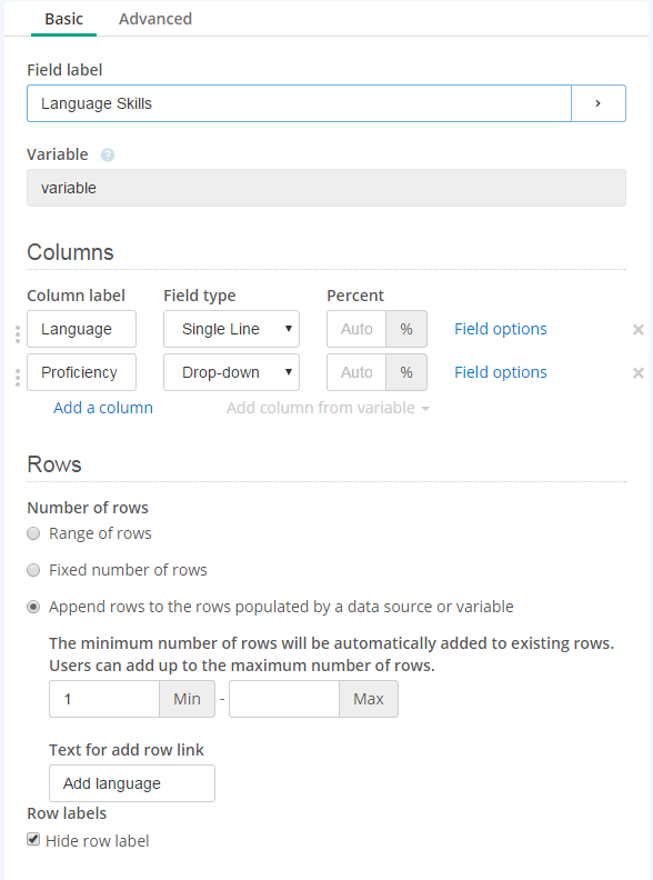

I have the following table in my form:

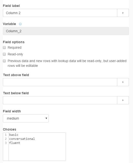

The Proficiency dropdown field has the following options:
  • Basic
  • Conversational
  • Fluent

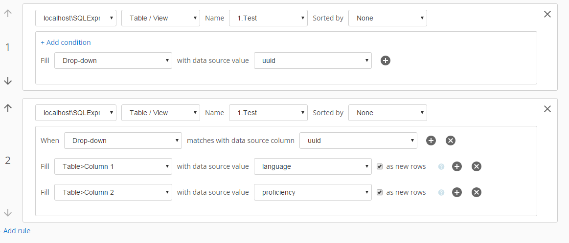

And here is my lookup rule. It's very simple:

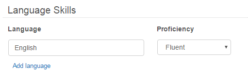

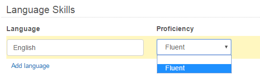

Here's what I get:
Which looks fine, BUT...
Where are the other two options in the dropdown? This is a form we send back to the initiator to let them make changes. What if they decide to get tested at the Conversational level instead of Fluent and want to change their language proficiency? (This was a problem in 9.1 and 9.2 as well, but it's such a game-breaking bug that we were assuming it would get fixed, or at least an alternative behavior provided as an option, as Eric indicated here.)

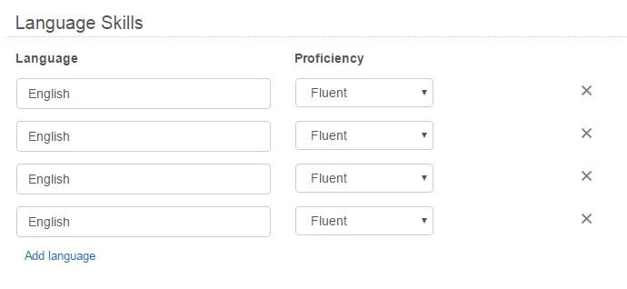

There's more... when I click "Add language", it keeps adding a row with the exact same data, when it should be adding blank rows:

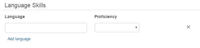

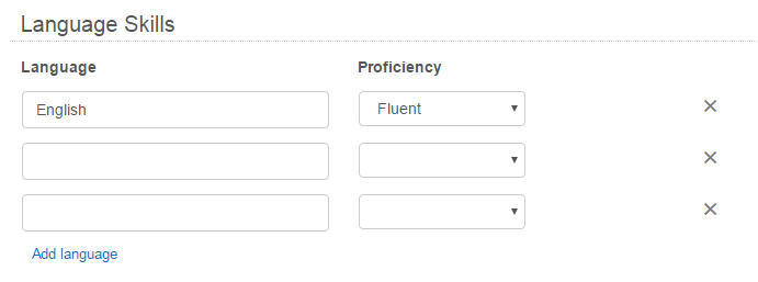

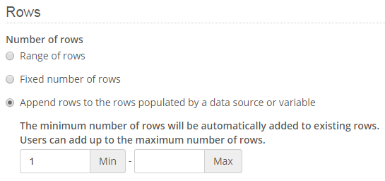

The table option clearly says "append rows to the rows populated by a data source or variable", so shouldn't it look like this instead when you click "Add language"?

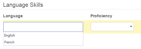

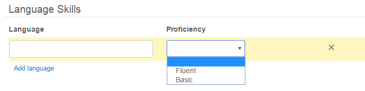

After the form loads with that URL, setting the uuid field value to "1", the table is now blank...
Oddly enough, the "Conversational" option is gone from the dropdown:
And English and French have been added to the Language single-line field as auto-suggestion values:
Am I missing something here? Because, based on how I have configured my lookup rule, and how this feature has been requested in the past, I expect this database table:

To be reflected like this on the form when the lookup rule runs:

Here are the lookup rules I used:

The proficiency drop-down needs to have all possible values that the lookup could return:
I noticed that your lookup rules do not have the "as new rows" check box. Usually, fields inside a table or collection have this option. I would try creating rerunning the Forms 10 Update 1 (making sure the Forms Routing Service is shut down during the install) and creating another test form. If this still does not work, I would suggest opening a support case.
replied on February 23, 2016
Collections have the "as new set" option but tables don't have the "as new row" option.
