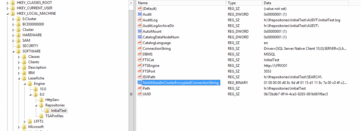

Initially The Laserfiche Server Started on Node 1 of the Cluster and we Created a test Repository.
I attempted to Fail it over to side 2 and was not able to get the Laserfiche Server to Start on Node2
