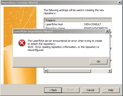

Hi,
While using the Laserfiche Repository Creation Wizard I encountered the error "server encountered an error when trying to create or attach the repository", 4025 - Error reading Repository Information  or Repository is misconfigured.
I am using version 9.2 and SQL Express 2012 Adv. The SQL server is recognized by the wizard but the final step of creating the new repository won't run and gives me the above error. I used Windows authentication and the LF server service account has sufficient permissions to the SQL server.
Pls can anybody help out?
replied on February 5, 2015
  • Do you have SQL server management studio? As a test, are you able to manually create a SQL db using that application?
  • Is the SQL instance you are trying to use in the same machine or on another machine?  If it is the later, please make sure that the LF server service you are using has Sysadmin rights to SQL.
  • You should also make sure that you are licensed for full SQL.  You can get this message if you are only licensed for SQL Express but are actually trying to create a repository using full SQL.
By correct permissions, does te Windows account have SysAdmin?
replied on February 6, 2015
Derek - Yes,the Windows account have Sysadmin.
Raymond - Yes i do have SQL server management studio and i was able to manually create a SQL db.
                   The SQL instance is in the same Machine and the LF server service has admin rights.
                   I am licensed for SQL express.
I have uninstalled and gone through the whole process again to make sure i didn't make a mistake. But I still get the same error message.
Thank you Derek and Raymond found the problem, it was the rights. I just had to look at it again.
