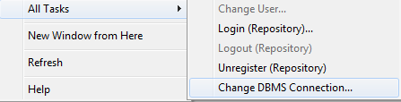

Hi Ahmed,
It sounds like something is wrong with the DBMS connection. Open up the LF admin console and right click on your repository then go to all tasks>Change DBMS connection.

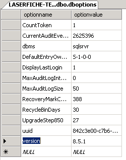

Are you sure you are connecting to the correct SQL db?  Using SQL server management studio, open the SQL db used by LF.  Look for the dboptions table and view top 1000 rows.  Look for the version row. What version shows there?
replied on November 13, 2014
Hi Raymond Cruz
- I used Network Account for LF server service and SQL service
- my SQL and LF in the same SERVER
- I am connect to my SQL using windows Auth and looking for dboptions table
the version =8.5.1
