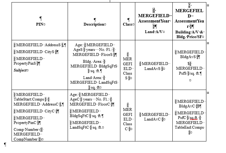

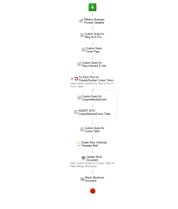

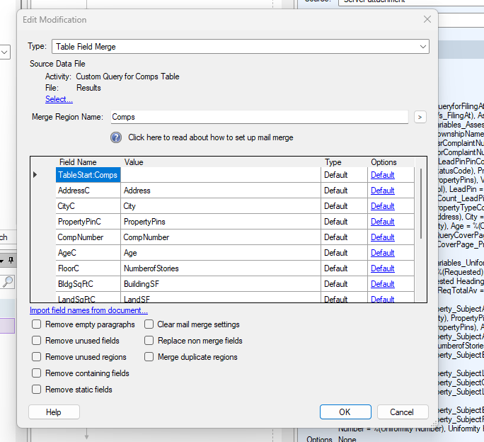

I am trying to set up a table merge in the update word document activity and for some reason even though my query for the table merge is finding 5 results - no rows are being populated in the actual word document. I have attached photos of both the update activity and word template for review. I have another working template that is identical to this one that works but for some reason mine is not.

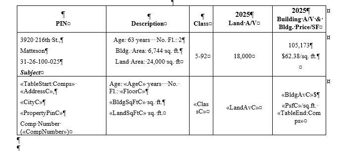

My end result after running the workflow produces the following:
Ive tried remapping the entire row and table. Nothing seems to be working.

Here is the document to update and sample workflow attached.

We got it to work, we think the issue is we were trying to have this is an insert paragraph with the INCLUDETEXT feature in word. It does not seem LF is able to do a table merge - only simple field merge. When we added the paragraph to the original document it worked just fine.

Great to hear it works. Actually, WF supports Table Field Merge which can be configured following this guide: Update Word Document.

Thanks, we have run into another issue though. When we put the table merge in an IF statement since the paragraph is conditional the table merge seems to break. It will show us the values when the field codes on are but when we turn them off the table rows go away. We think this has to do with the IF statement itself since we have another identical table that works just fine. Do you have any advice for this issue?

2. Added the same paragraph in an IF statement and also left the hardcoded version in as well. Resulting in both paragraphs not merging. Very weird activity.
I have attached my word document with both the IF and hard coded table. Essentially this has two queries one for the subject row and then the table merge grabs rows for a query
