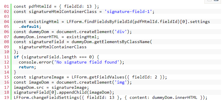

using this code snippet from the above answer and tweaking it a bit better fit my scenario; I ended up with this:

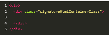

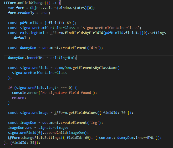

I had it set to onFieldChange for testing purposes, but this takes the image generated from the signature and appends it to a preexisting block of custom html. The custom html block looks like this:
This whole setup works as intended as once the user signs, that signature data is grabbed and placed within the div. My initial assumption was that would save the html and would continue onto the next process stage. Also note following the suggestion from this thread:
https://answers.laserfiche.com/questions/209594/LFForm-object-ChangeFieldSettings-in-Custom-HTML-field-does-not-save-changes-to-repository#209812
I set the form to read-only, or at least I think I do. I'm not quite sure how or when the form needs to be set to read-only, but from my research I know that any change can only be saved when the form is in read only. Of course, this was the first thing I tried before going down this path, along with following the suggestion of this thread:

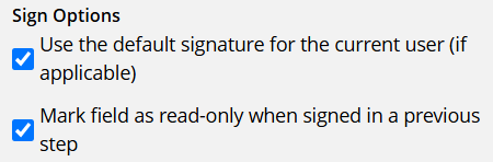

With self-hosted, that functionality wasn't added until Laserfiche 12 (I believe it was with the first release in November 2024).
Since this post is tagged as Laserfiche 11, it unfortunately means this isn't an available option, without upgrading to 12.
My recommendation would still not be to try to do this with code however.  My recommendation would be to make a second copy of the form, with the only difference being that the signature field is marked read-only on the second copy.  Any tasks that need to refer to the form with the signature field already populated would use the second form where it is read only.

If you select "Mark field as read-only when signed in a previous step", it will carry the signature through the rest of the process, including the save to repository task. No javascript or html required.
