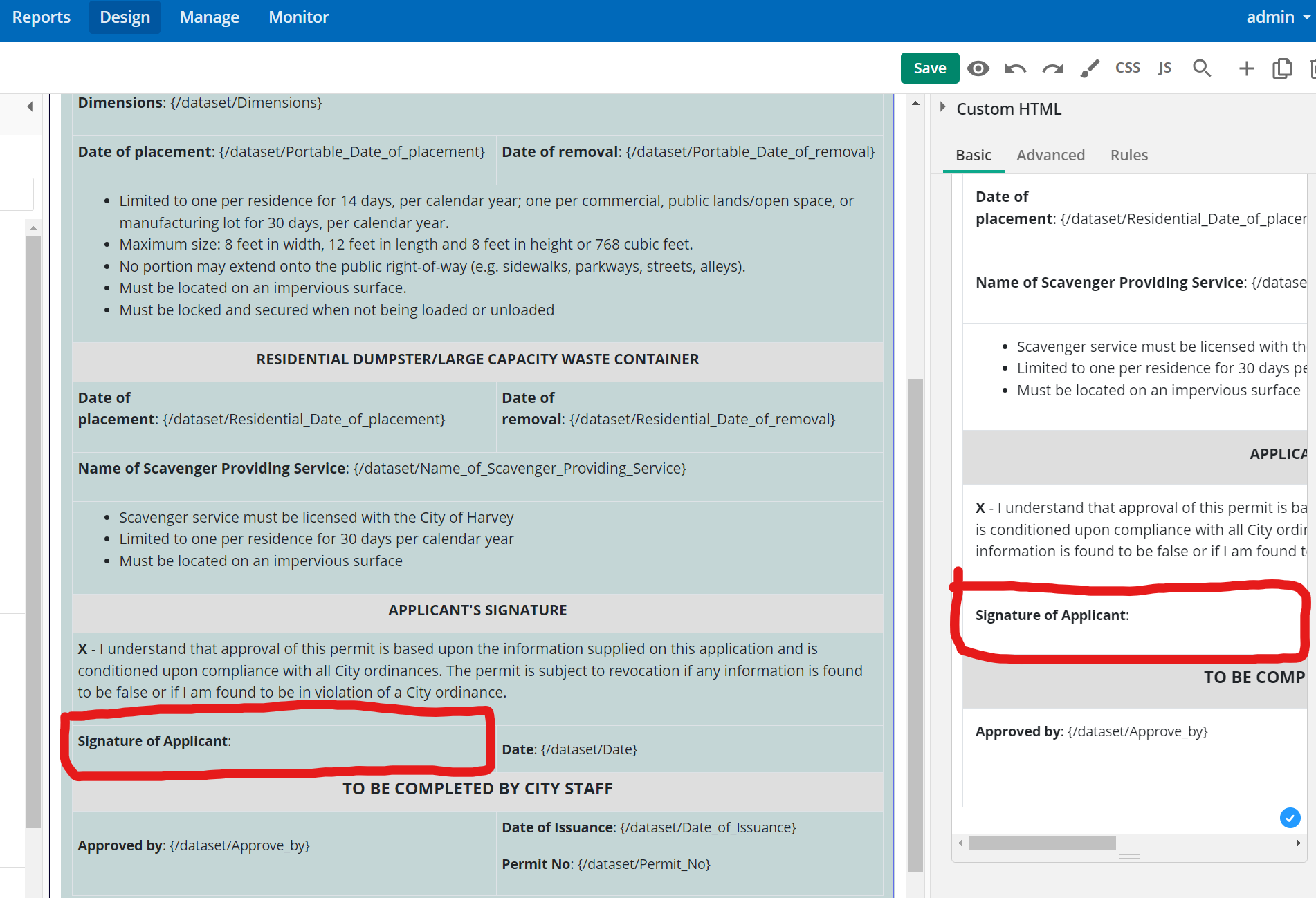

The main reason for putting the signature within the HTML is because the client wants the final form to resemble in format the same one they have already designed on paper, so that the end client will not find it strange to see when they receive their digital copy. .
So in order for me to be able to design the form with the same visuality or similar to the form they have on paper, the only way I know is to do it through CSS and HTML code to give it a visuality very similar to the one in which the paper form exists.
For this reason, I am designing a form with the sole objective of filling in the information of the Tokens that would already be stored in the database from the beginning or during the different stages that the form would go through to in the end give the end user all the information. information you need to receive in the format closest to the paper form.
I'll give you an example image of what I'm trying to do. Where I circle you in red is where I am supposed to put the signature so that when the client receives that PDF form the image of the signature is displayed in that place, so I don't know how to do that part. Any suggestions you can give me would be very helpful.

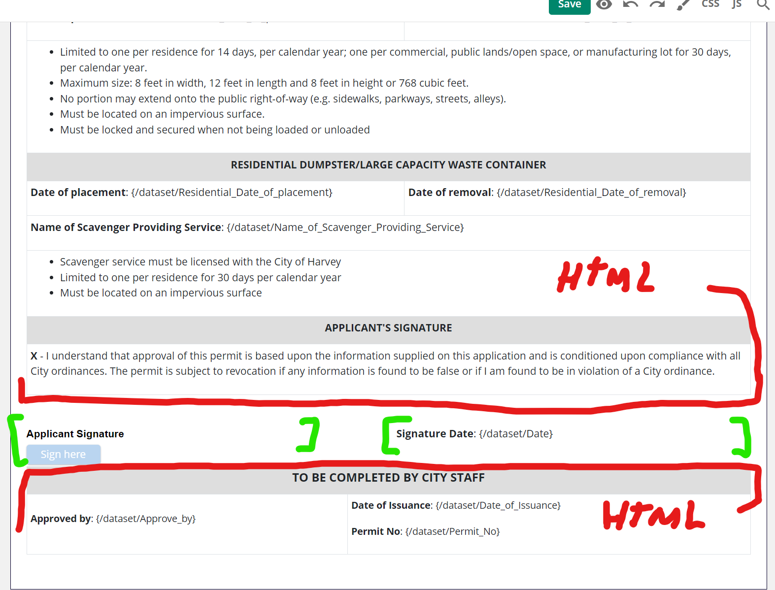

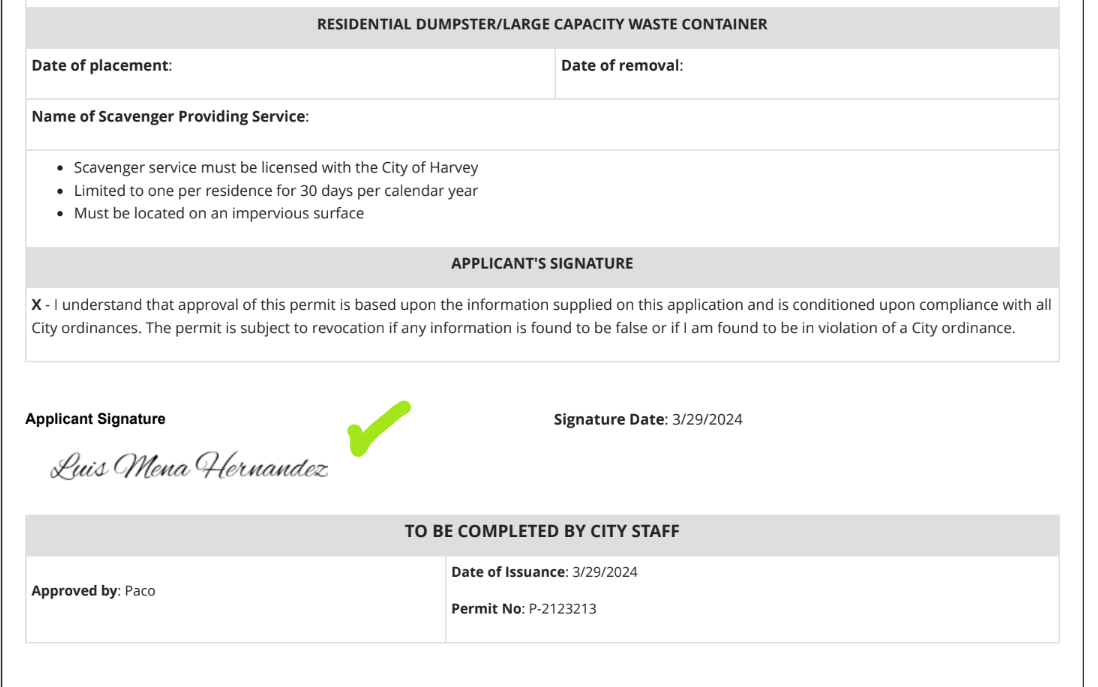

Well, after several hours racking my brain looking for a solution at the code level, and variables and etc. I have found a possible solution to my problem, which may not be the right one or the most indicated, but by applying a little logic and some CSS it could work for anyone.
My interest was to export the data related to the final form to PDF in a format similar to how the form is designed in its paper version and send it via email, in addition to saving it in the repository, in order to achieve this I needed to obtain the signature in image that I could adjust and fit where I needed it according to the design of the paper form.
I realized that in this case, I could solve it by using two HTML tools instead of one where everything was joined together, and between these two HTML blocks place the Signature tool in Read Only and show the variable of the date that was signed next to it, taking advantage of the benefits of the new modern form design interface. That way using the Signature tool as read-only I could display the signature image as I needed.
The next thing was to readjust via CSS the positions and distances of the HTML blocks and the styles so that all the information was seen as needed.
Here I leave you a cut of the form in editing mode and then the result.
Thank you very much for having answered my concern, likewise, any solution that could be better applied is welcome.
