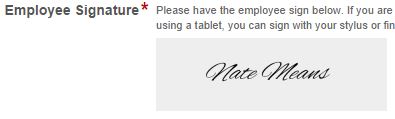

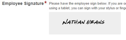

We have switched some of our processes to use the new signature field in Forms 9.2. We are seeing a problem with a submission we just received. Below is a screenshot of the signature that was gathered at submission.
The next step is a Supervisor Approval step. Here is the signature that shows on that form:
The step after that is an HR Assistant step. Here is the signature for that step:
What happened to the signatures? Each signature field has the same variable.
replied on October 7, 2014
Hi there,

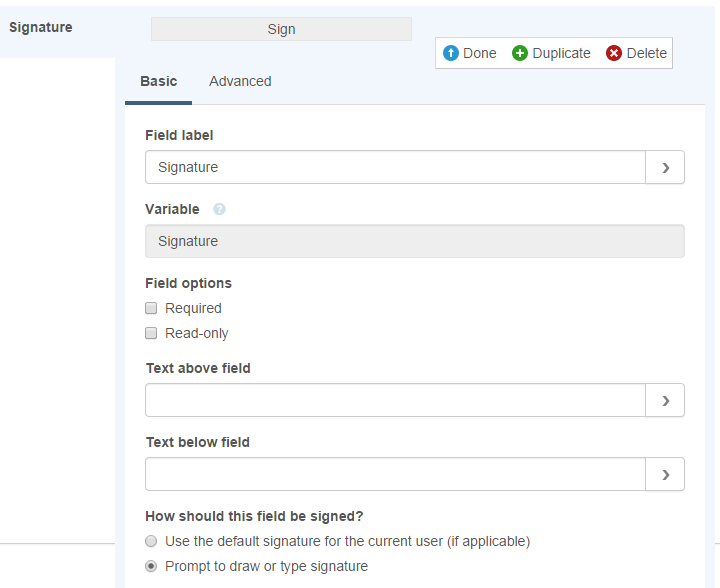

The signature field will display the original value if it's a readonly field.
If the signature field is not read only, which means this form needs to be resigned, the original value won't be populated.
Please try set the second form signature field to be readonly.

This is by design. The signatures are only meant to show on the saved forms the person who performed the task. I have not yet played around with Forms 9.2 for the signatures yet, but from the documentation, you may want to make that field read-only in the steps after which it was used.
Tip: If a specific signature field is used on multiple forms (e.g., you used the field's variable to add it to multiple forms), the signature will be editable on all forms unless it's made read-only. For example, Sally has a form that needs to be signed by an employee and then routed to a manager for review. She makes the signature field read-only on the form the manger reviews so the manager will see the employee's signature instead of a Sign button.
