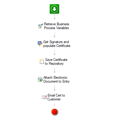

replied on October 29, 2024
Hi Matthew,
I have applied what you recommended in the post link and I have been able to solve my problem with inserting the signature in a PDF.
What I did was convert the PDF into a Word Document, in the place where the signature should go I put the annotation that you recommended, and I created similar annotations to search and replace for the variables that I needed to put in their place and then I converted the document to PDF, I attached it to an Entry to save it in the repository and I sent the PDF document back to the client with its complete Certificate.
Thank you so much for your guide.
