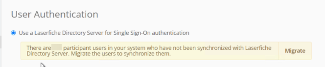

You will first want to check and see if any of the accounts have an @ symbol in their username. If they do, you will want to change that as it is not supported by the built-in account migration tool in Forms. The usernames need to be changed in the cf_users table first and the Forms application pool and routing services need to be restarted before running the migration tool.
Since you don't have any LDAP accounts, next you can switch Forms to use LFDS authentication. After you do this you will see a message on the User Authentication tab of the /FormsConfig site like the following:
Click the Migrate button to start the migration of the Forms Authenticated Participant accounts. This will migrate the accounts to Directory Server.

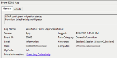

When you select the option to Retain the AD SID, you will receive a prompt to confirm. Click Yes. The migration runs in the background.
To know if it has finished you can go into the Windows Event Viewer on the Forms Server and check the Forms App node. You will look for an event that states "LDAP participant migration started". A second message will say the LDAP participant migration ended.
You can also verify in the Forms database that in the cf_options table the LdapMigrationStatus value equals 5. If this value does not equal 5, do not continue and open a support case. ​​​​​​​
