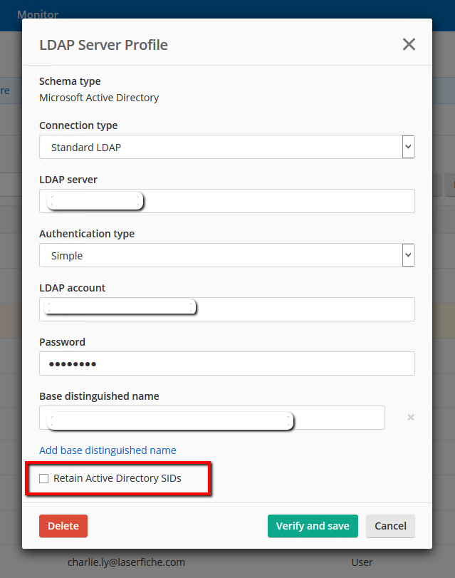

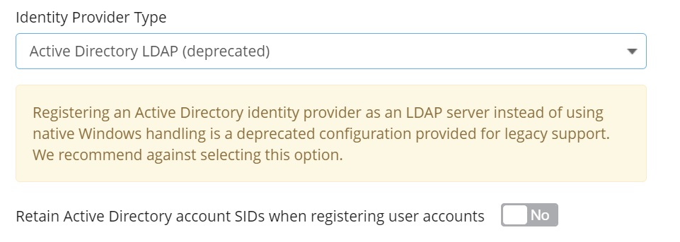

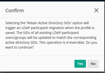

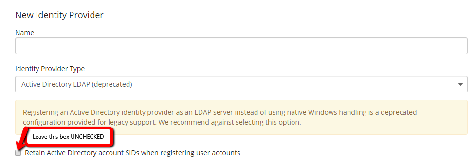

You should determine whether your LDAP participant users have retained their AD SIDs or not.
  • If you are on a version prior to 10.4, the users do not have AD SIDs
    • To convert to regular Windows users in LFDS, you must first upgrade to Forms 10.4
  • If you are on version 10.4+, see pictures below
If you see this box and it is UNchecked, then the users do not have AD SIDs:
If you check the box and save, you will be prompted to migrate the SIDS to AD SIDs:
Once all users have AD SIDs, then you can proceed according to the steps in my earlier reply

Perfect! I upgraded them to 10.4 specifically so that we could retain the SID.

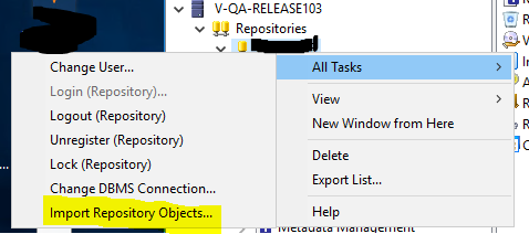

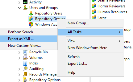

We did just have an issue when running this tool where all of the Laserfiche Groups and Repository users were migrated to LFDS, but the Repository Users did not retain their groups and they all had to be reassigned.
replied on September 12, 2019
Hi Blake,
I think this is a matter of insufficient/unclear information and the utility is behaving as intended, so I want to explain the expected behavior in more detail.
When groups are migrated to LFDS, they are intended to replace the repository groups. As such, the new groups in LFDS should:
  1. Have the same membership as the repository groups, including child groups and LDAP or AD users. That is, if user A and group B belong to group X in the repo, there will be a user A, group B, and group X LFDS, and user A will instead belong to that group C
  2. The newly created LFDS groups will be marked as trusted for login for the repository they came from
  3. The rights, privileges, etc. assigned to the repository groups using the repository group SID will be replaced with the SID for the new LFDS group, so that all rights etc. are transferred over to the LFDS group
    1. The exception is any attribute set on the Everyone group such as Settings lockdown that involved an admin manually specifying a GUID
  4. The utility has a step to handle conflicts, so if you have the group "Admins" in repo 1 and "Admins" in repo 2, you can either merge the two or rename the later group(s) when the conflict is found.
The migration utility steps say
All repository group memberships will be retained. Repository groups will become new Directory Server groups. Windows and LDAP users in repository groups will appear as members of the migrated groups in Directory Server, as long as their identity providers were pre-registered in Directory Server.

A workaround:
1. Prior to running the utility, export your repository groups as XML
2. Modify the XML to change the group name so it's not identical to the Laserfiche group
2. After running the utility, if your windows users and windows groups were not properly added to the new LFDS groups, re-import the repository groups:
This isn't ideal, since now you still have repo groups, but you can then add the LFDS groups to the repo groups and continue to use the repo groups in the future.
Alternatively, you could also use the exported list to either script adding the AD trustees to the LFDS groups using the LFDS SDK, or for smaller systems as a reference for manually fixing the membership through the LFDS admin console.
