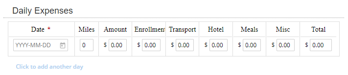

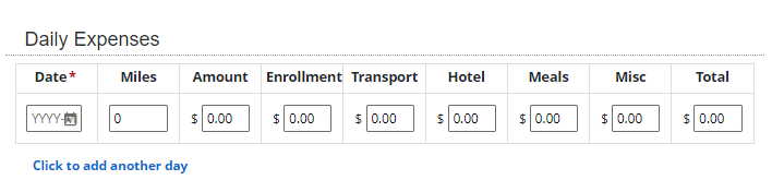

I am working with the Forms layout designer (not classic version).  I have a table for which I need custom column widths.  I have used CSS to achieve this.  When I add the code to the column, I see the width change to what I'd expect in the layout, however, after I save the change and preview or run the process, the column width defaults back to no formatting.  See screenshots below for the width I see in layout mode vs preview mode. Note the wider width for Date and smaller width for Miles in image #1 vs image #2.
LAYOUT MODE
PREVIEW MODE

Are you having the same issue described here or here?
replied on April 26, 2023
Yes.  The solution offered by another user is not working for me, but the issue is very similar in nature.  I understand that it is a bug that will be addressed in the next update.
Which version specifically are you on?
Because the issue I reported in the other two posts was not inside a table, and when I tried to replicate your table just now, it didn't give me the same issue.
I'm on Version 11.0.2212.30907
Other ideas you could try as a work-around, similar to the one I commented on the other two posts:
  • Shrink all the fields to the right, instead of the left, leaving the first field as the largest.
  • Save multiple times without making other changes.
  • Delete the table and re-add it from variables.
  • Throw your laptop against the wall.
    • Just kidding on that one, don't do that.
It could be related to this bug that involves tables.
Just a suggestion as a work around, have you tried using bootstrap codes for the layout?  https://getbootstrap.com/docs/3.3/css/#grid Add the codes to the CSS field on the Advanced tab for the individual fields.
