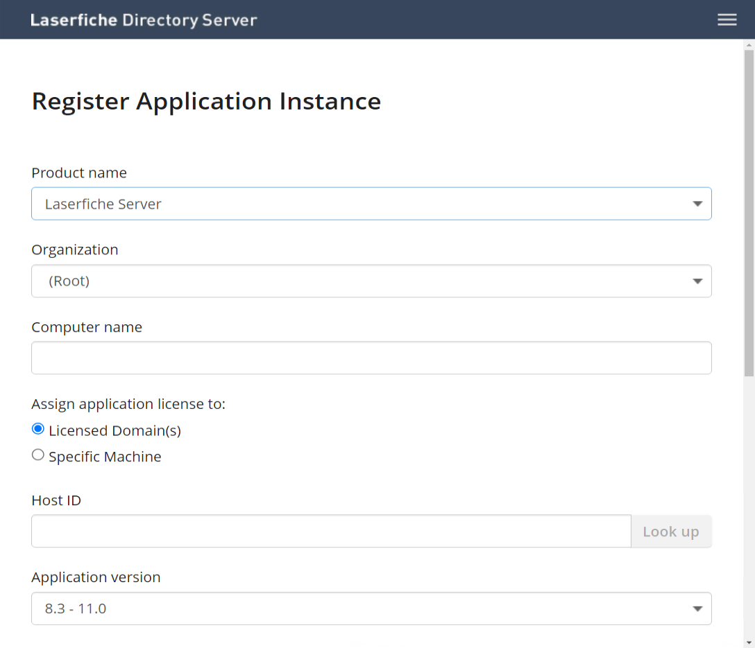

Laserfiche Directory Server (LFDS) 11 can license Laserfiche Server (LFS) 9.2 instances. It can license down to LFS 8.3. We'd highly recommend upgrading to LFDS 11 first.
If you haven't updated to a Domain Locked license for this customer yet, we'd recommend doing so. There's no cost and you can submit the request for automatic fulfillment from the Activation Keys section of the Support site (scroll all the way to the right).

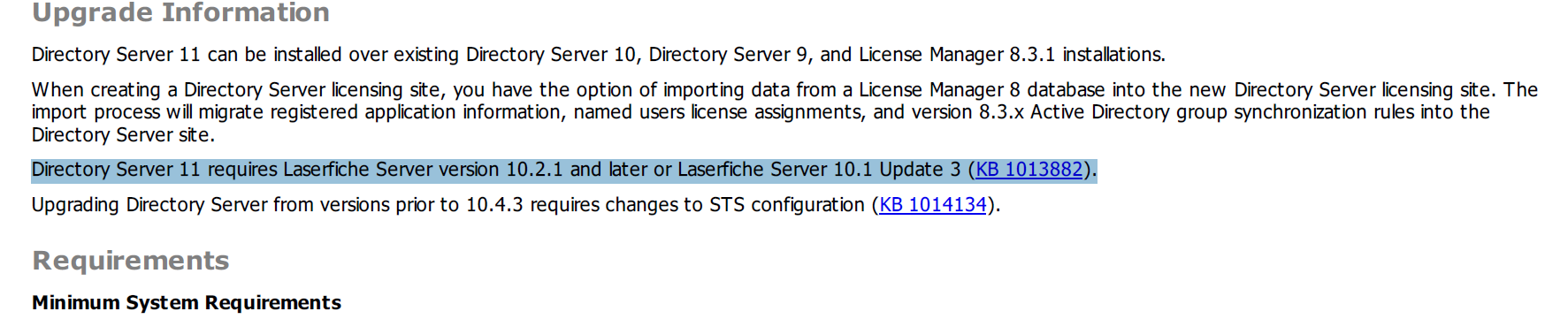

Please check the attached document, it mentions that DS 11 requires LF 10.2 and above only. please advise.
replied on December 15, 2022
Good catch. It appears that while LFDS 11 can issue licenses for LFS 9.2, there was a bug affecting user authentication that does require using LFS 10.2.1+.
See: https://answers.laserfiche.com/questions/126653/Directory-Server-102-requires-Laserfiche-Server-version-1021-or-Laserfiche-Server-101-Update-3-KB-1013882
I can't think of any reason that License Manager 8.3 wouldn't be able to issue LFS 11 licenses. It's just a "MaxVersion" property in the license file. You might have to refresh/renew the license in License Manager first in order to pick up the latest MaxVersion property value from our license servers before you can issue licenses for LF 11 applications.
