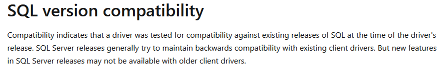

I looked up the Microsoft guidance on ODBC driver versions and found this:
https://learn.microsoft.com/en-us/sql/connect/odbc/windows/system-requirements-installation-and-driver-files?view=sql-server-ver16
So even though the v11 driver wasn't officially tested with SQL Server 2019, that explains why everything still works more or less though perhaps not optimally. I don't think it's the cause of the specific error message I'm seeing as that seems to be more to do with network conditions or perhaps a VMWare nic issue.
Though, I'm a little surprised we didn't get some kind of warning about this on either the Laserfiche side or the SQL Server side. Or if we did we somehow managed to overlook it.
