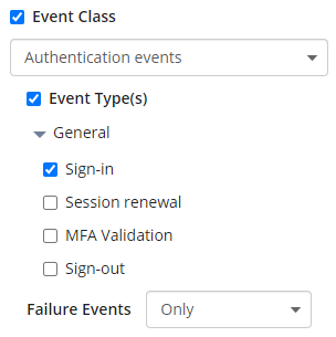

What version of LFDS are you using? On recent versions you can check in the Audit Configuration tab on the LFDS site that "Sign In Failure" is being audited under the "Authentication events" section. After ensuring that is the case, if your license includes Audit Reporting you can search for events like so:
