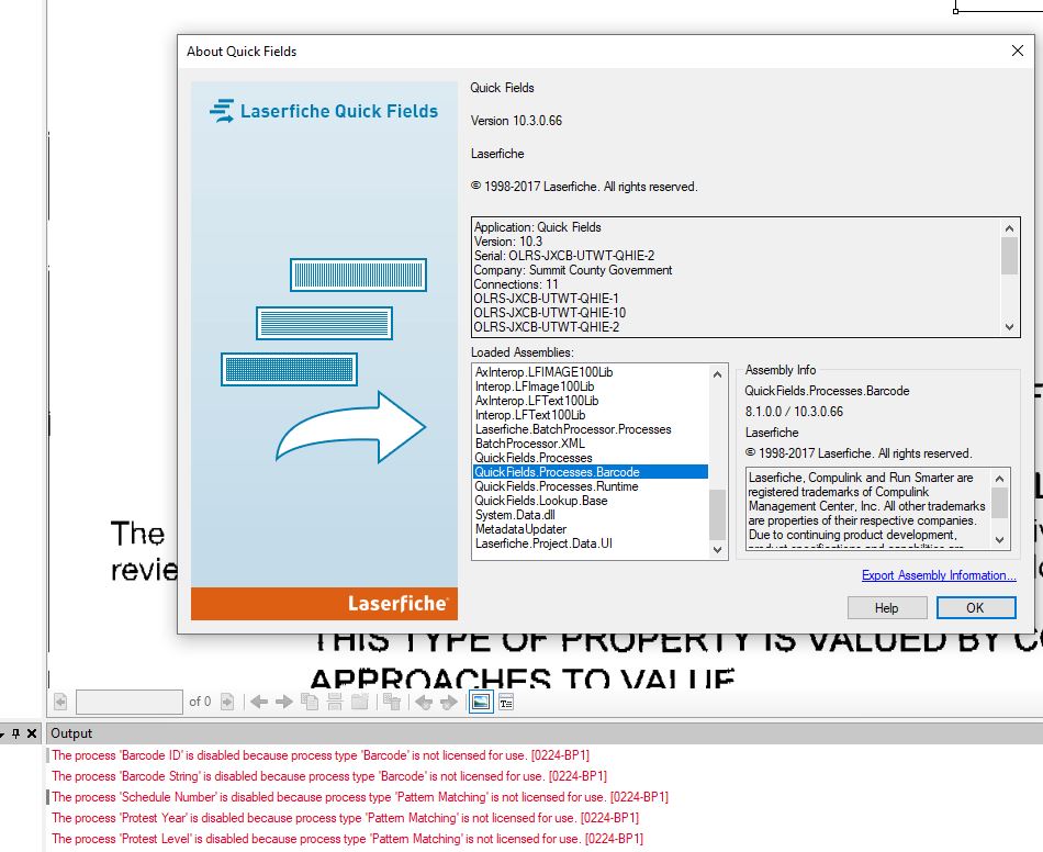

Working through installing Quick Fields under RIO for the first time (QF 10.3).  After installing and activating QF, I'm attempting to open an existing session from version 8.3 - when I do so, I get a series of errors in the Output window saying that all my process types aren't licensed (Lookup, Pattern Matching, Barcode, Substitution, etc.).

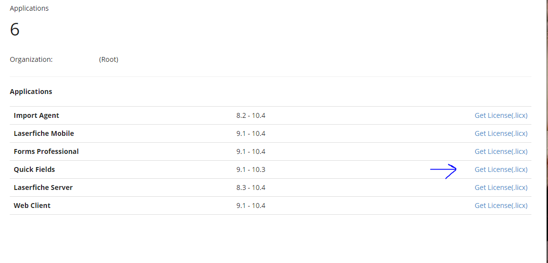

Did you make sure to pull the QF license from LFDS and replace over old .licx?  It would be under machines, QuickFields, Get License.
1. You would install QF
2. Add QuickFields Applications to correct machine
3. Choose Get License(licx)
4. Save in same path as QuickFields install Over the old licx license

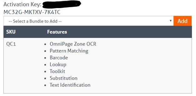

Prior to installing QF on the workstation, I had gone into the support site and added the appropriate Bundle to each instance of QF that we have (10 licenses).  (Example screenshot attached).
Then I installed QF on the workstation and activated it via LFDS and associated the QF instance.  I assumed QF would pick-up the licensed features that I had already added to the bundle.  However, I did just try your suggestion to go through the Add features process - it didn't resolve it.

I'd taken a look at that issue you referenced but wasn't sure if it was relevant...  When I open the About box I don't see a section called 'Features'.  However, 'Barcode' appears listed in the loaded assemblies even though it's listed as not referenced in the Output window. None of the other missing processes are listed in the Loaded Assemblies.

replied on December 31, 2019
on the first box about Loaded Assemblies, where it shows you the Application and Serial, scroll on that box until you see features.  What does that show?
*above loaded assemblies
No features listed.  Just the list of serials for our licenses/instances.
Yes, that is the problem.  The QuickFields activation key you are using does not include the bundle you mentioned.  If it did, it would show in that area.  I would reach out to your reseller to see if the correct license was purchased.
