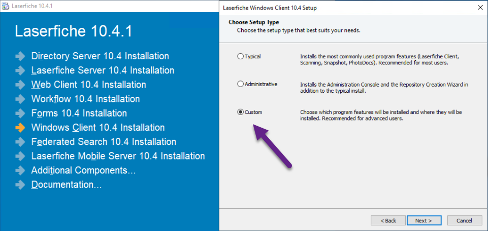

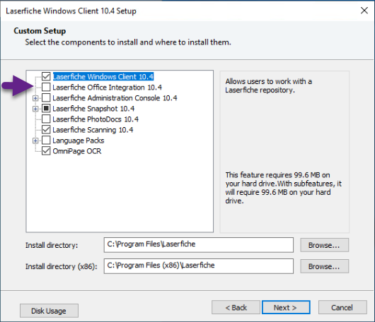

Hi Drew, you can select with components of the Windows Client suite you want using the Custom option in the install wizard. The unattended install levels Craig mention correspond with those options.
Uncheck "Laserfiche Office Integration" and ensure only components you want to install are checked.

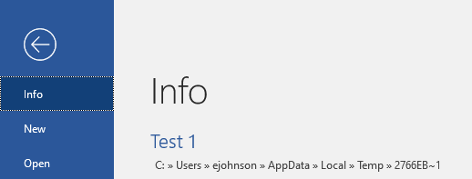

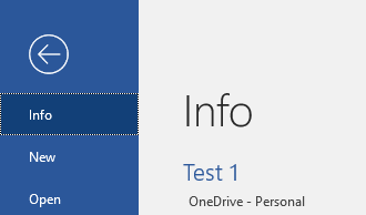

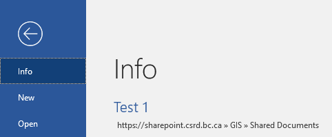

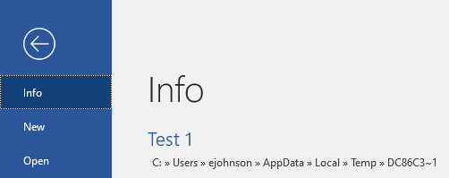

We're having this issue to. The issue: When the Laserfiche Office Integration is installed and the Add-In is enabled in Microsoft Office programs:
1) User opens a document for editing from SharePoint or OneDrive,
2) User clicks save for the first time. Any edits done before this save properly to the file location in SharePoint or OneDrive.
3) After save is clicked for the first time, the document file location changes to a temp location.
4) The user can continue to work on the document and save it but if they don't realize it's saving to a temp location and they close the document, they lose their work.
The behavior is exactly the same for documents opened from SharePoint 2013 or OneDrive. I've attached screenshots to display what I mean.

For clarity, the first time save is clicked, the work saves to SharePoint or OneDrive, but any time the document is saved thereafter (when the save icon changes), the document saves to the temp location.

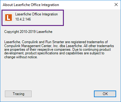

Emily,
Thank you for providing all of this useful information and reproduction steps. No need to make a new Answers post at this time as the issues are related.

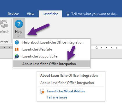

Could you let us know what versions of the Laserfiche Office Integration, Office/Word, and SharePoint you're running? You can check the former like so:
Which will pop up a screen like so:

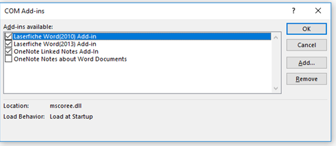

I've found a workaround. We don't need the add-in enabled in Word and that was the main program causing us issues. The add-in is enabled in Outlook and that's resolved our other issues.
