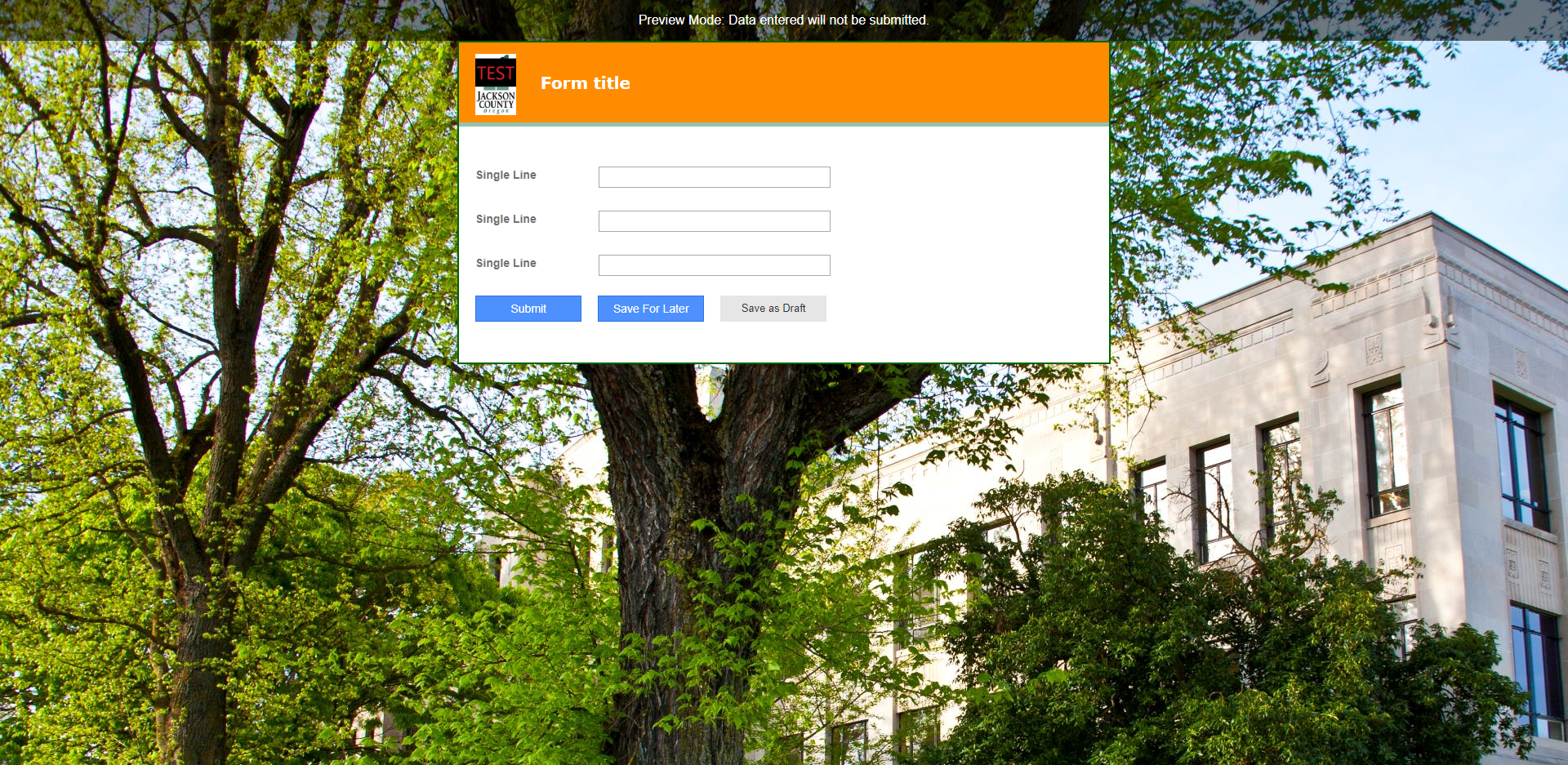

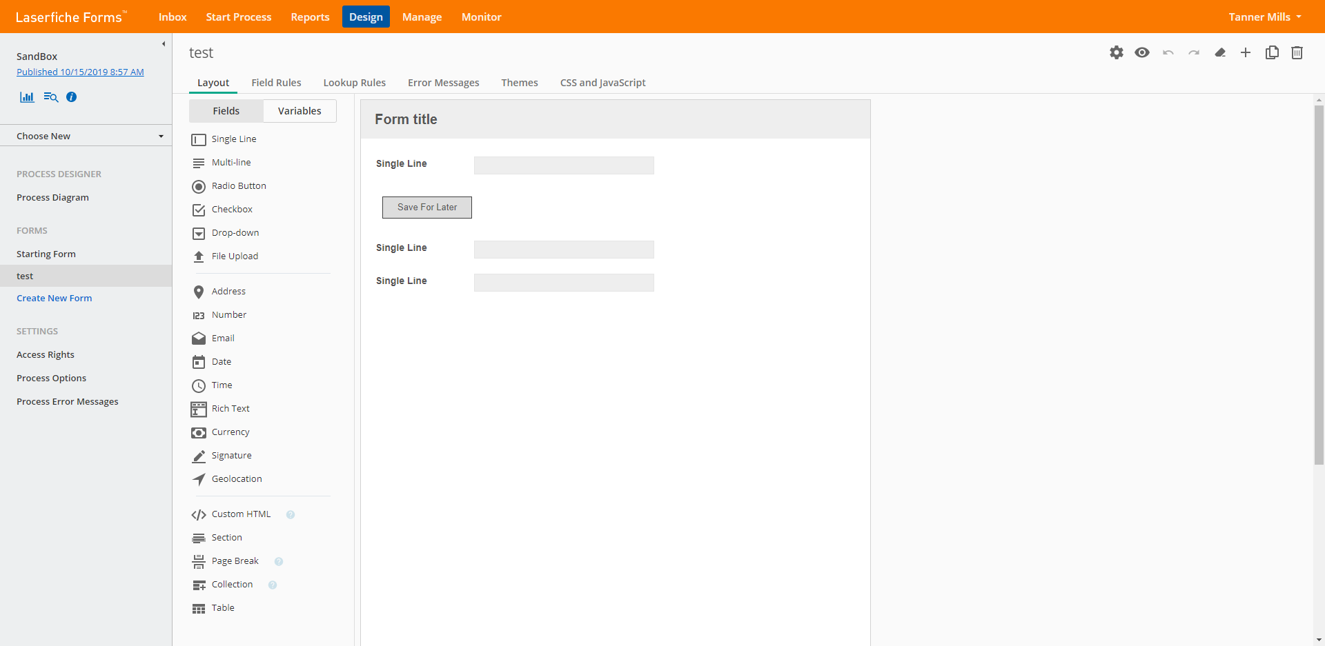

So first, the button's HTML code:
<input type="submit" class="newButton action-btn Submit" value="Save For Later" aria-labelledby="action" name="action">
I used an input element to match the other buttons that Laserfiche creates. The "newButton" class is so I can target that button specifically should I need to. The "action-btn" class is a built-in class that makes the button look like the other buttons. And the "Submit" class gives it the same look as the other buttons (we turn ours blue, but it stays the same based on the theme settings). The value is what shows on the button and what you will use in your "User Action" part of the process. The 'aria-labelledby="action"' is just a part of the other action buttons.
Now to add this to the bottom (and remove the blank space it leaves behind use the following JavaScript:

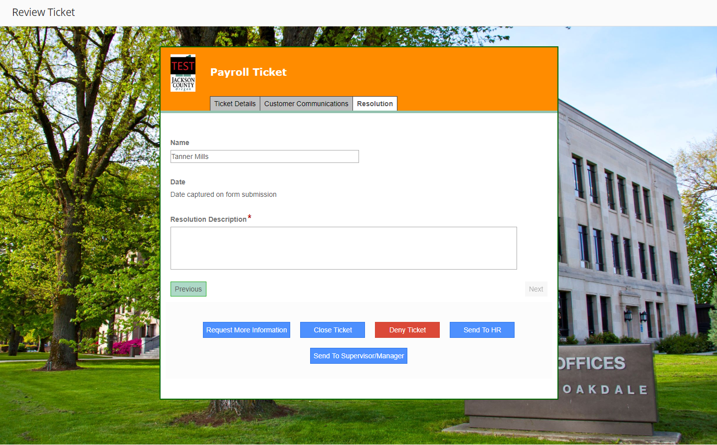

For the sake of image integrity, I've attached the photos I have since they are over the 1MB limit to put it in the post itself.

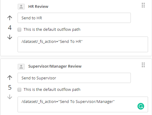

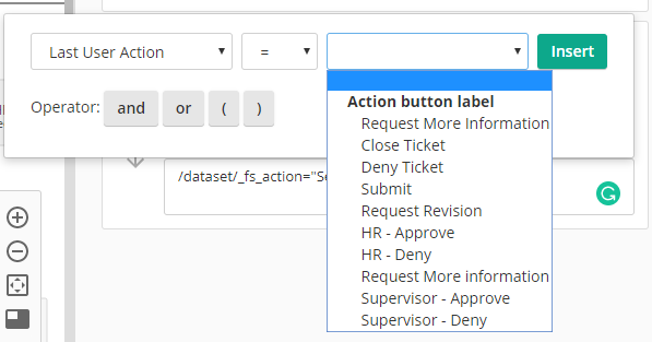

EDIT: I'd like to clarify a point that I didn't touch on enough. When adding the conditional expressions to your gateways the buttons will not list on your dropdown of actions. This is because Laserfiche Forms only recognizes buttons it made itself. To get around this (as shown in the pictures below) you need to add a blank "Last User Action = " expression and fill in the value of the button.
I show in the pictures below that the buttons I had added aren't listed in the dropdown, but the next two pictures after that show that you can type into the empty parenthesis the value of the button you are trying to use.
I can show what the flow looks like if anyone is interested (through the monitor tab). It will show what Forms would see when the custom action button is clicked.

I have a form which a Committee uses to approve or reject a candidate for their program on campus.  Right now the three buttons read Fully Admit, Admit with Conditions, and Reject.  What I need is a fourth button marked No Vote for when Committee members don't have to vote because a majority has already been reached.  Thank you!

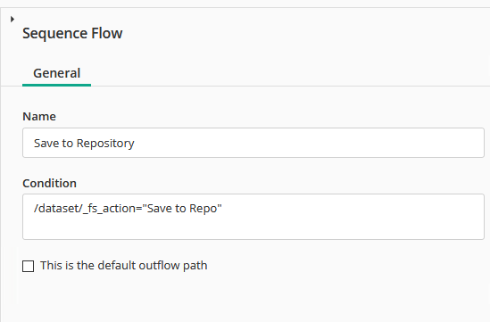

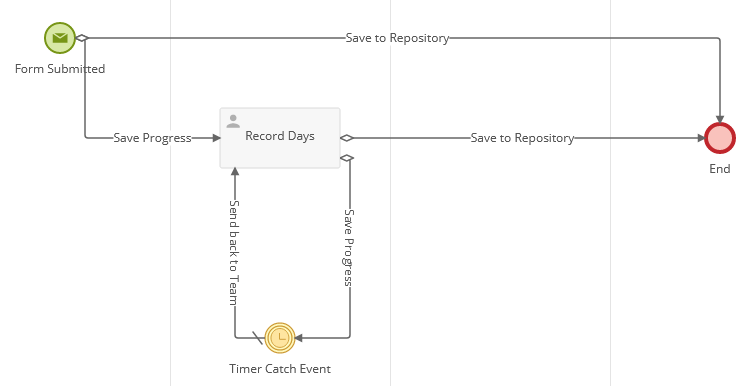

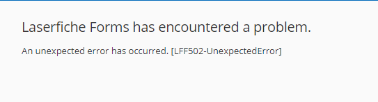

replied on March 8, 2021 Show version history
I am tying to do this on the initiating form and it's just terminating when I click the added button or the default submit button and I'm not sure why. At first I thought it could because I had set up a 'normal' button on the second stage with the same value. So I changed the value from "Save to Repository" to "Save to Repo" to make sure the two buttons did not conflict with each other but It still is not working. I am using the default submit button and named it "Save Progress"
What they are wanting is if a team member is entering the data they have the option of saving directly to the repository or saving the progress and making the form available for another member of the team to pick up and add to the form.
My custom HTML
<input type="submit" class="saveToRepoButton action-btn Submit" value="Save to Repo" aria-labelledby="action" name="action">
My JavaScript (note I commented out the call that would be used if it was not an initial submission form)
$(document).ready (function () {
  /*                      START: Move Additional Action Button                        */
  /* https://answers.laserfiche.com/questions/167540/Additional-Action-Buttons#183898 */
  /* Moves button from form to lower button wrapper and removes DIV that button was   */
  /* housed in                                                                        */
  /* used for initiation/submission form */
  $('.saveToRepoButton').detach().appendTo($('.btn-wrapper:first'));
  /* used after initiation/submission form */
//  $('.saveToRepoButton').detach().appendTo($('.button-wrap:first'));
  $('#q271').remove();
  /*                       END: Move Additional Action Button                         */
}); /* END: $(document).ready (function ()*/
Image is how I have the action set up
If I remove the added button my submit(Save Progress), works as expected and sends the from to the next step.
Do you have access to the Monitor tab? I might be able to shed some light on it if you can get the Error Log text and if the Value of the button shows in the "Action" column of the process that terminated. Thanks!
It looks like the action matches as far as the values it is showing. How would I find the error #/msg I can see variables tab but I don't see error listed there.
Found the error msg....
Error 3/8/2021 1:28:44 PM
No condition should be set for the outgoing sequence flow of a start event "Form Submitted" (business process ID: 93, step ID: 20). [LFF5402-RemoveConditionFromStartFlow] Details: URL: Error: RemoveConditionFromStartFlow Date: 3/8/2021 1:28:44 PM (Central Standard Time) HTTP Status Code: 400 Business Process ID: 93 Instance ID: 2056 Business Process Name: HC: COVID-19 Daily Monitoring Log Stack Trace: Caught exception: Laserfiche.Forms.CommonUtils.Exceptions.LFFormsException Message: No condition should be set for the outgoing sequence flow of a start event "Form Submitted" (business process ID: 93, step ID: 20). [LFF5402-RemoveConditionFromStartFlow] at Laserfiche.Forms.Routing.StartEvent.GetAllSubsequentSteps(Int32 instanceId, Int32 processId, Int32 sourceStepId, IRoutingContext routingContext) at Laserfiche.Forms.Routing.RoutingContext.GetAllSubsequentRoutingSteps() at Laserfiche.Forms.Routing.RoutingDispatcher.GetSubsequentRoutingStepList() at Laserfiche.Forms.Routing.RoutingDispatcher.ExecuteSteps(Int32 processWorkerInstanceId, ActionType action, Int32 stepIdToAct, String comment) at Laserfiche.Forms.Routing.RoutingDispatcher.RunProcess(Int32 currentStepId, Int32 processWorkerInstanceId, Int32 processId, Int32 boundaryEventStepId, SubmissionDataSet inputData, Int32 mainProcessInstanceId, Int32 refMainProcessInstanceId, Int32 lastSubmissionId, PaymentParams paymentParams) at Laserfiche.Forms.Routing.RoutingEngineService.RunRouting(RoutingRequestParameters requestParam) at Laserfiche.Forms.Routing.RoutingEngineService.<>c__DisplayClass6_0.<StartRouting_Async>b__0()
I'm not sure this would help but here is my process diagram so far.  Should I maybe have just the one path out of "From Submitted" and add an exclusive gateway and then check the action at that point and rout accordingly?

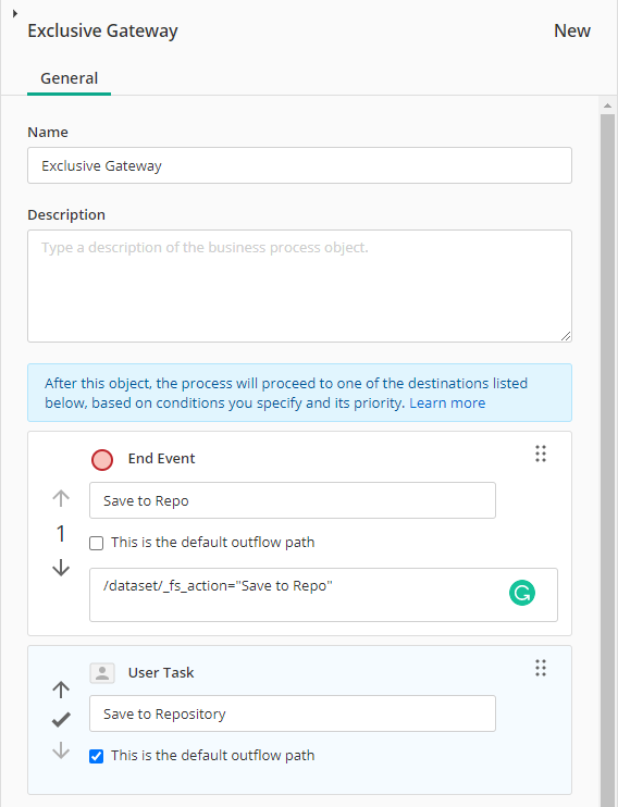

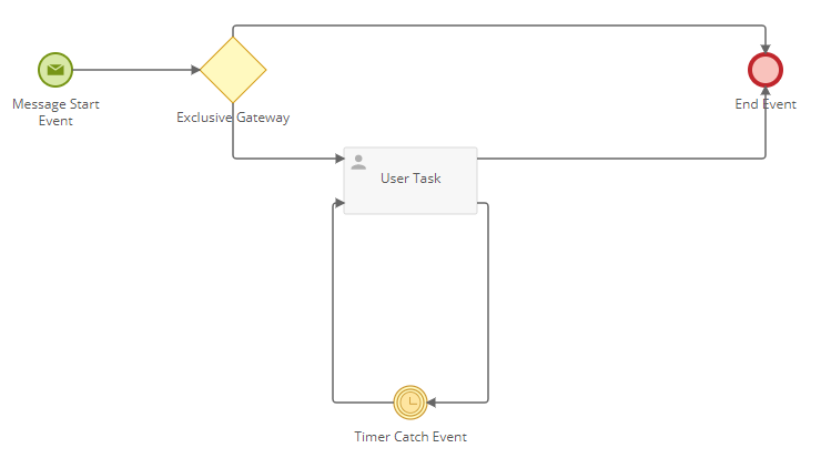

I was just writing to ask about the process diagram. What you'll need to do is set an exclusive gateway that the start event flows into. Here's a picture of what yours should look like:
The exclusive gateway should be configured like this:
You can also set a condition for the "Save to Repository" path if you have something specific in mind, but when there are two paths and one has a condition and the other doesn't, having it as the default path can prevent unintended terminations or suspensions.
This should fix the problem. The underlying issue wasn't actually the button, but the fact that the start event didn't like the condition paths coming directly from the event itself.
Let me know if this doesn't fix it and I'll see if I can find a different reason.
Just an update got it working... adding the gateway. :) Thanks for your help!

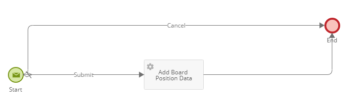

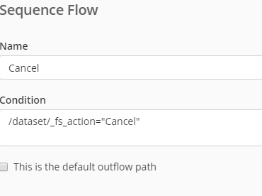

replied on March 6, 2020

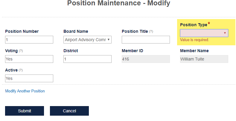

I guess this is the part where I should ask what the cancel button is expected to do? Do you want it to "submit" the form but in a state of cancel? Or do you just simply want to close the form out completely? Or is there an ulterior motive behind it (maybe close the form but submit it with the fact that the user clicked the cancel button?
I'll make you some code to do what you need it to. I think the current way we're going about it is much more complicated then you need. I'll also explain what it does so you can learn a little bit about how I got to that code.
I REALLY appreciate that.  I have created a "Menu" form that calls other forms with hyperlinks.  So, what I want the cancel button to do is Exit form without submitting anything.  In the message event I selected the redirect to website radio and put the URL to the "Menu" form.  So when I cancel out of the form I want it to redirect back to the menu.
replied on March 6, 2020 Show version history
Ok. So to save you any complications (both in the process diagram and the coding portion) I made this for you.
<input type="button" class="newButton action-btn Submit" name="action" value="Cancel" aria-labelledby="action" onclick="location.href='YOUR URL HERE';">
That is the same button your using now, but it will go to the URL you place in the appropriate spot. This closes out the form without submission and goes directly to the URL.
So if you want it to go back to the menu, put the menu URL in place and it will close the form and automatically go back to the menu. The nice thing about this way is that it won't clog up your monitor tab with processes that were canceled.
As usual, let me know if this doesn't work.
EDIT: I should add real quickly, make sure to add the https:// or http:// to the URL or it will try to open the URL by placing it at the end of your forms URL.
Beautiful.  Much easier and works great!

replied on February 27, 2020
Thank you for this info.  I applied your code but I have an issue.  When I go to configure the Sequence Flow, the Action is not listed.
Excellent catch. I didn't highlight it but included a couple of pictures that showed it (I'll bold it for future cases). Since this is a "custom button" you have to add the value of the button yourself. Laserfiche only recognizes (in the backend) buttons that it creates itself.
The 2nd, 3rd, and 4th pictures show that they won't list them in the dropdown.
The fix for this is to add the Last User Action="" to the expression and fill in the value you set for the button inside the parenthesis. The value you place inside the parenthesis is the value="" part of the button. I say this because it's possible to set the value to something other than what is displayed on the button itself.
If any of that is confusing or you can't figure it out, just let me know.
Got it.  You have to insert it first then edit it.  I was trying to edit the value in the field before I inserted it.  Thank you!!!
Getting an error when clicking new button.  Here is the process
Seq Flow
Error
Html
<input type="submit" class="newButton action-btn Submit" value="Cancel" aria-labelledby="action">
replied on February 27, 2020 Show version history
That might be my bad, or it could be a new change to the back-end. Add  name="action" to your HTML. It got it to work on my quickly put together process. I'll edit the code above now.
EDIT: Actually it was my bad, I have name="action" on all of the other code portions. I must've just missed it on the first one.
Bingo -- Thank you!
It's kind of weird it gave an error though. My quick mockup didn't pop an error it just went down the submit path instead and ignored the other path completely. But I'm glad it works for you!
replied on March 5, 2020
The Cancel button is working great.  However, if there are required fields on the form the Cancel button cannot be used in the same way as the submit button.  Do you know how to get around this?
replied on March 5, 2020 Show version history
Hi Jim,
Here is a bit of code I commonly use for reject / return buttons that removes the required attribute from all fields when clicking a reject button (add reject class for custom buttons):
      // If "reject" button is clicked
    $('.Reject').click(function(){
      // un-require required fields for reject button
      $('input, select, div').each(function() {
          $(this).removeAttr('required');
If you have more than one "Reject" button, you can also add an "if" statement validating the value (text) of the cancel button you want to act on.
Thank you.  I will give it a try!
I am having issues getting this to work.  I am not a java developer so that is probably why.  :)  Below is the code I am using for the button.
<input type="submit" class="newButton action-btn Submit" name="action" value="Cancel" aria-labelledby="action">
Hi again Jim,
  So, based on that code. To do what Sean said above you would place this in your JavaScript.
//When the newButton classed button is clicked
$('.newButton').on('click', function(){
   //cycle through every input, select, and div in the document
   $('input, select, div').each(function(){
      //remove the required property from the current object (this)
      $(this).removeProp('required');
I added some comments to the code for you to better understand what it's doing. Let me know if that works.
You could also try adding a class (maybe cancel or something like that) to your code you posted. Then change the .newButton to the class you entered. That would allow you to have a different class for each button you might add. However, if you're not planning on adding any more buttons, by all means, keep it like that.
I'm here if you need more assistance. Good luck Jim!
Thank you very much.  I added the code but the clicking Cancel button still does not remove the required property.  I am not sure what I doing wrong.  Here is all the java on this form.
$(document).ready(function(){
//Moves button from form to lower button wrapper and removes DIV that button was housed in
$('.newButton').detach().appendTo($('.btn-wrapper:first'))
$('#q117').remove();
replied on December 6, 2019 Show version history
Addendum - sometimes the div class to identify the buttons is "button-wrap" instead of "btn-wrapper."  This appears to be the case when working off a user task vs. an initiation form.
Sean is actually 100% right and I missed that in my post. The code below is what you would use to add the button when dealing with a form after the initiation/submission form.
$('.button-wrap').append("<input type='submit' class='action-btn ellipsis Submit sendToHR buttons hidden' name='action' value='Send To HR'><br class='lf-responsive-navigation'>");
This does the same thing as the code above but will target the button-wrap for the form when it's not an initializing form.
You can also simply change the code from above:
  $('#q2').remove();
To this code below:
  $('.newButton').detach().appendTo($('.button-wrap:first'))
  $('#q2').remove();
Good catch Sean. Thanks!
