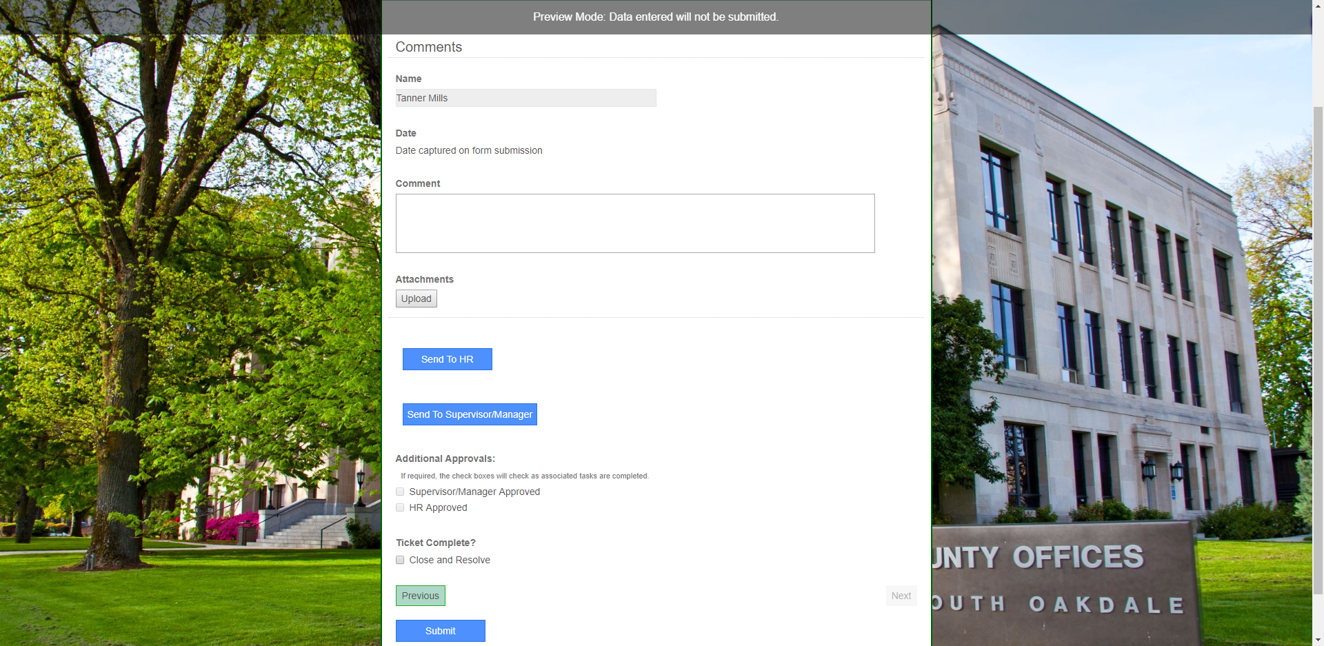

So the two pictures I attached illustrate what the buttons look like on the form. They aren't currently moved to the bottom, but for this use-case, I don't necessarily need them down there as they are tied to the updateable checklist below them.
The code of the custom HTML button I used is
1<input type="submit" class="action-btn checkRequired Submit sendToHR buttons" name="action" aria-labelledby="action" value="Send To HR">

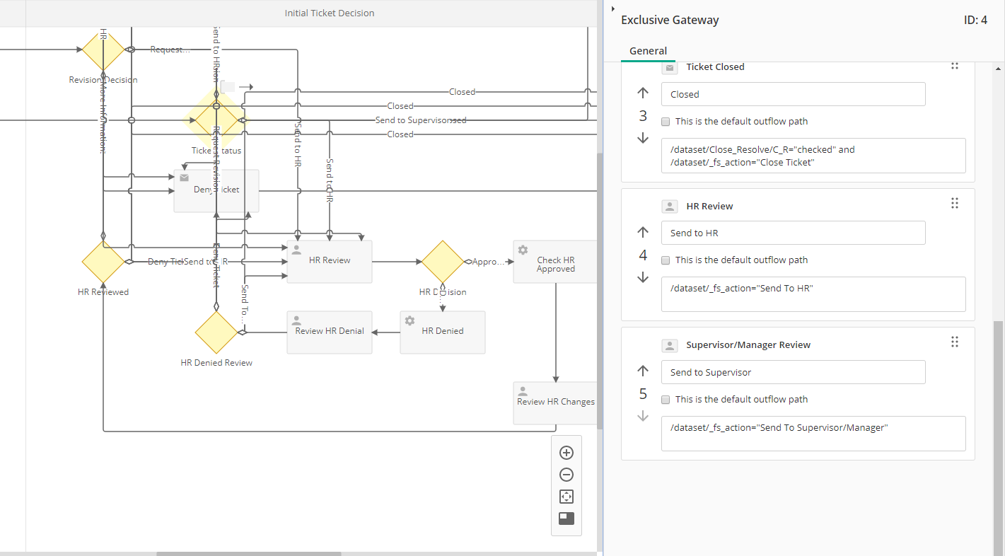

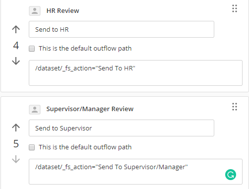

  I only changed the "sendToHR" class to be "sendToSupervisor" on the other button. The part that determines what the button's action is, is the value="" part. The pictures also kind of illustrate that if you look at what the button says and what the fs_action value is (in case it's unknown the fs_action is the last user action).
Now my form I have done quite a bit more than just that to customize the form. But that should get you another button you can reference in the process diagram.

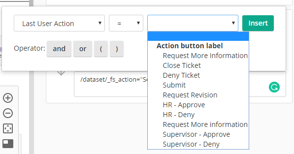

KEEP IN MIND: The dropdowns for the last user action will not populate the choice as it's not created by Laserfiche. So you will have to insert it with a blank value and fill it in yourself. Check out the Process Path pictures for what I mean.

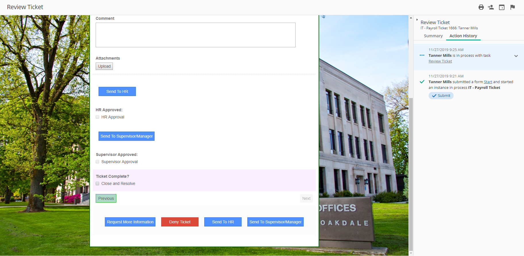

So after making that and playing around with the process. I decided to try my hand and making the buttons also act as the action buttons at the bottom of the page do. And I'm glad to say I got them working exactly like the action buttons now. The thing that's unfortunate (and also not) is the targeting of them for certain things.
The screenshot attached is the previous two extra buttons, now down next to the other action buttons. They hide and unhide depending on the page just as if they were other action buttons. Below is the code I used to add them to the button navigation div.
1$('.button-wrap').append("<input type='submit' class='action-btn ellipsis Submit sendToHR buttons hidden' name='action' value='Send To HR'><br class='lf-responsive-navigation'>")
2
3  $('.button-wrap').append("<input type='submit' class='action-btn ellipsis Submit sendToSupervisor buttons hidden' name='action' value='Send To Supervisor/Manager'><br class='lf-responsive-navigation'>")
The key to making them hide and unhide is setting the hidden property first. Laserfiche's system in the background adds and removes it to input fields automatically so it handles it for you.

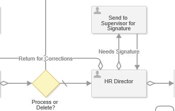

You bet. If you look at the screenshot below of one our processes, you can see the HR Director task already has 3 outgoing flows which takes up the existing 3 buttons (Submit, Return for Corrections, and Needs Signature).
We would also like a 4th button called "Delete" that would take a different path from the other 3.
We have another part of the same process where Payroll receives a form. Before it gets to Payroll it goes through a number of other user tasks. We would like the ability for them to be able to send it back to any of those user tasks depending on if information is missing.
As I mentioned in the original post, I know that we can add a field to the form that could be evaluated after the form is submitted, but we have found our users prefer to have a button that says exactly what is going to happen if that button is clicked.
