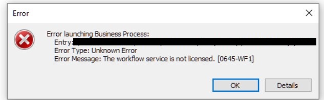

First we saw this:

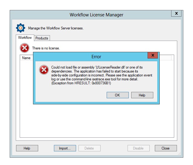

Then we saw this when trying to apply a license with a license file:

That's...interesting. I would recommend contacting your reseller and opening a support case.

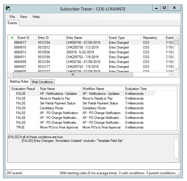

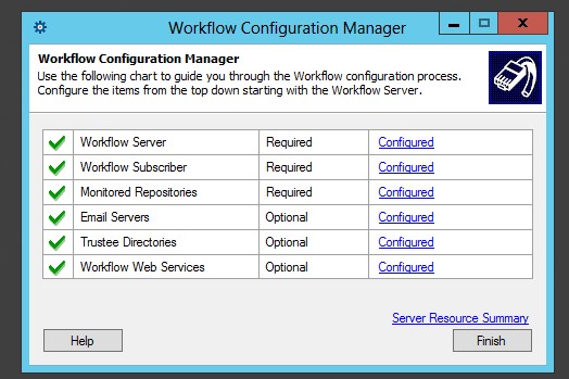

However, our records show you're running Avante, so you don't need a Workflow license. Your Workflow server will consider itself license once it connects to a repository on an Avante Laserfiche Server. So...is your Workflow Server fully configured? If you check the Configuration Wizard, does it show any warning messages or is it all green? If you look in the Workflow Admin Console and open the Subscriver Trace, does it show a tab for your repository? Any warnings there?

It looks fully configured:
This is the Subscriber Tracer I don't have any tabs besides the event tab:
