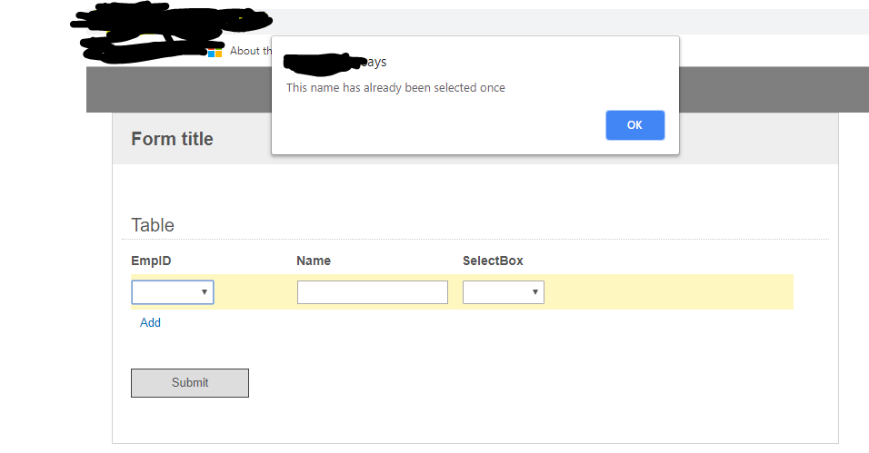

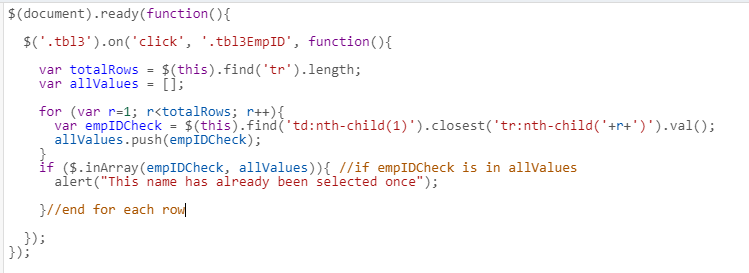

here I attach two pics for my code and preview, when i try to select from empID Column alert come without selecting, only when focus to select field.

Looks like the filter could be the issue.
What happens when you add in the 'option' to the filter?
$('.tbl3').on('click', '.tbl3EmpID option', function(){
this tells it only to run when an option is clicked.
You could also try:
$('.tbl3').on('click', '.tbl3EmpID:selected', function(){
