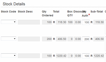

Hi,
I would like to disable a list of options in a drop-down based on what the user has previously selected. The Drop-down is in a table and is linked to a lookup rule. If the user already selected a stock code, then they should not be allowed to select it again in additional rows, thereby creating duplicate lines.
Below is the field called "Stock Code" with class name ".stockCode". This is the end result of my current script, which is also pasted below. As you can see, the first row did not perform the lookup as expected. I was able to select from the list, which then triggered my script. You cannot see very easily on the screenshot, but the entire Stock Code drop down list is now disabled for the first row after the script runs. If I add some rows, then those rows perform the lookup as expected and their drop-down options are not disabled at all. Clearly, something isn't right with my script and I could use some help getting it to work.
Here is my script:
$("select").change(function()
     var tr = $(this).closest("tr");
        tr.find('.stockCode option').attr("disabled",""); //enable everything
     //collect the values from selected;
     var  arr = $.map
        tr.find('.stockCode option:selected'), function(n)
              return n.value;
    //disable elements
    tr.find('.stockCode option').filter(function()
        return $.inArray($(this).val(),arr)>-1; //if value is in the array of selected values
     }).attr("disabled","disabled");
I got this script from here: http://stackoverflow.com/questions/27490401/prevent-multiple-selections-of-same-value-for-each-table-row
Although the script appears to work if I plug it into JSFiddle to test, I cannot modify it to get it to work on my own table in Forms.
Any ideas?

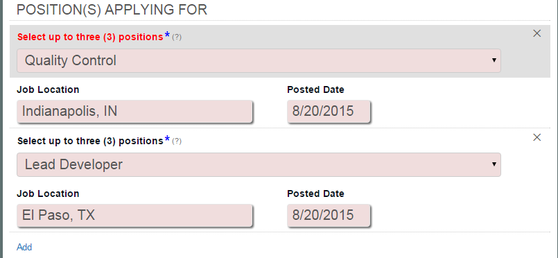

Ege,
I'm attempting to do this as well, but not getting success in exporting the value to Laserfiche.  The main difference is that I'm using a collection, not table and I'm guessing that is where I'm going wrong.  Below is my code and the information is not passing to the repository (I'm trying to apply the 'job' field to a field).

   			selects.find('option[value='+svals[i]+']').prop('disabled',true);
$(document).on('change click','li[attr=vendorcontacts] select.cf-medium.form-control,span.form-del-field', function(e) {
        	setDropOptions();
You may need to play around with the classnames to find your selects but it works.
