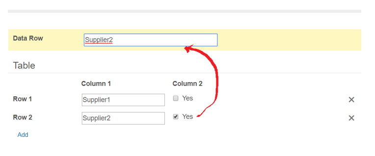

Is there a way to populate an input box from a selected data table (via a checkbox)? This is the simplistic version. The idea is that the user adds the required number of suppliers and select one (the selection could also be done by a higher level user at a later stage).
Once you select the checkbox for a particular supplier, it is supposed to:
  • Unselect a previous selection (if exist)
  • Move the selected supplier name to the “Data Row” input box
Not sure why, but the first-row checkbox has to be ticked to get any kind of result which defeats the purpose and is obviously wrong. I can get the id of my selected row (i.e. row 2) but always have to go back to row 1
The classes assigned were:
Data Table = “myTable”
Checkbox section in data table = “dataCbox”
ID for Data Row = “q35”
I started the following code (sorry I know it is still far off - please ignore completely if I’m on the wrong track):

I hope this makes sense.
Thank you for your assistance.
John

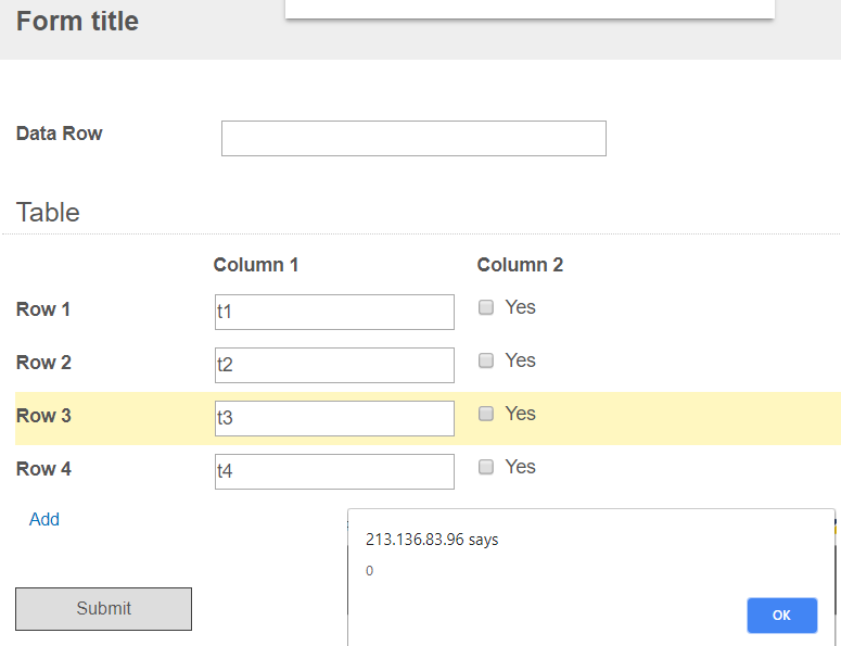

I started by using the code to see how many rows it return. I expected 4 rows in the example below.
I first wanted to make sense of it.
   $('.myTable').on('click', '.tableCbox', function(){
           var totalRows = $(this).find('tr').length;
         alert(totalRows);
The above are the classes defined on the form. I also assume that I must use "$(this).find('tr').length;" as is. What am I missing? Lol - apart from being totally new to jquery - :)
Thank you once again.
Regards, John

replied on February 4, 2019
Did you have to click a checkbox for the alert to pop up?
Is .tableCbox the class that is on the checkbox field in the table?
Also, is the table's class .myTable?
Sorry for the questions. Need to confirm to troubleshoot.
Thanks
You can try changing your code to:
   $('.myTable').on('click', '.tableCbox input', function(){
         alert(totalRows);
(I added "input" to the cbox filter)
