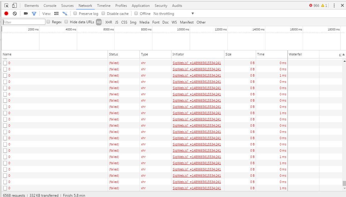

replied on March 16, 2017 • Show version history
Good Morning Everyone,  I have made the above mentioned edits to the script, with 10.2, update 1, and SigWeb installed, and still not working properly.  When the form loads and the signature button is clicked, the signature pane does display and switches to only the draw tab at the top, however, when you sign on the pad, nothing is displayed on the signature pane on the screen.  I am attaching the script I am currently using, which i believe is the same as Alexander's recommendation above with the exception of localhost being replaced with our LF server name.  I am also attaching the warning that is seen in the Chrome console when the signature window displays.
One last thought/question...  What does enabling SSL change to this process?  I am working with a test server to enable SSL and am seeing various warnings if i leave the path to the server as http://server or https://server.domain.coms,.
