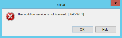

Hello,
I am having this error i n my Workflow designer when I try to start a workflow.
Can anyone help please?

Hi Ketsia,
What version of LF workflow and LF server are you using?
What Licensing model is this? Avante, Rio etc?
This error was also discussed here - https://answers.laserfiche.com/questions/53229/Laserfiche-Workflow-91-License-Error-0645WF1
Hope this helps poing you in the right direction! smileyyes

The VAR demo uses Avante, so Workflow doesn't have a license in this case. In Avante and Rio cases, Workflow is considered licensed when it is monitoring a licensed Avante or Rio repository. So in this case, the error would indicate the LF Server license has expired or no monitored repository is configured.
For legacy United or Team systems, Workflow requires a license. It's not stored in the install folder. You can provide a new license through the Workflow Admin Console (Server Configuration\Licenses) and the server will store it where it needs it and load it without requiring a restart.

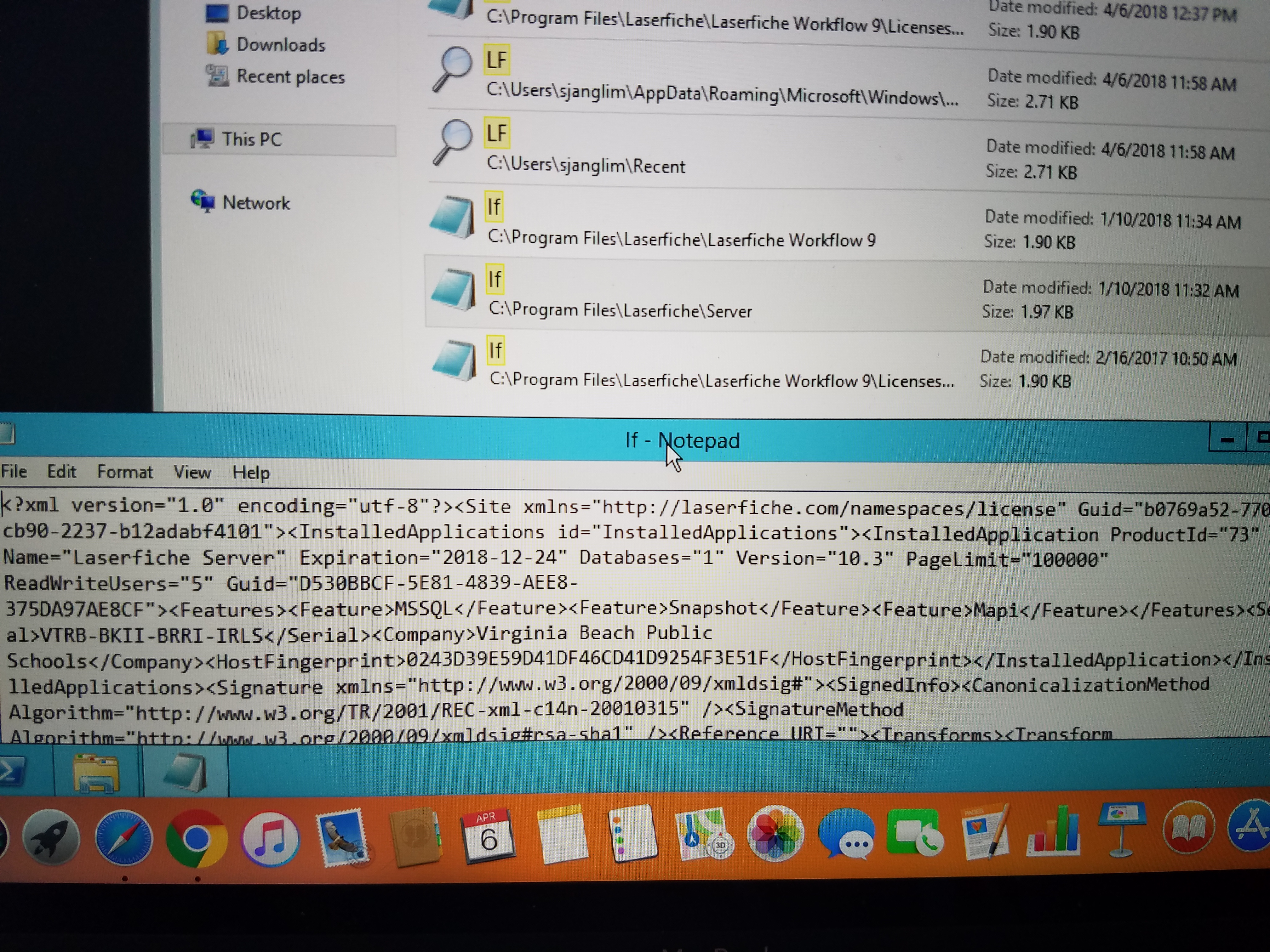

I am having the same issue.  I have found 4 copies of this file.  I am showing an expired date for the \Laserfiche Workflow 9\Licenses and \laserfiche Workflow9  -- 2017-12-24.
The other two files are showing 2018-12-24.  Can I just change the two expired dates and save the file?

workflow is actually licensed by your LF server. Check the LF.licx file in the server directory C:\program files\Laserfiche\Server\lf.licx
replied on April 6, 2018
Hi Chris and thank you :)
The date on that file is 2018-12-24.  See attached...
Any other ideas?
Thanks again,
Sue
Actually, according to our records, you're running Laserfiche United, so Workflow needs its own license. You can look in the C:\Program Files\Laserfiche\Laserfiche Workflow 9\Licenses\70 folder if you want, but the easier way to check (and replace) a Workflow license is from the Workflow Administration Console. Look under Server Configuration\License and it will indicate if it's expired or not. If it's expired or you don't see one, you'll need to get one by reactivating your Workflow key.
