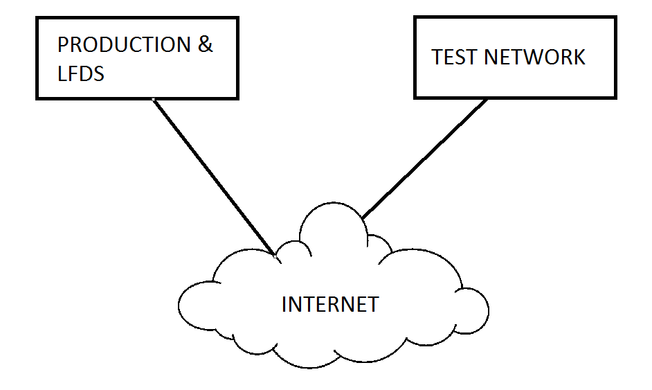

Yes, thats the problem. Here is a crude diagram of what the setup would be:-
The issue here is that the networks are physically seperate, how can you get LFDS to "call home" over the internet?

replied on June 16, 2016
So, the LFDS machine, wherever it may be, would have a public IP. The app servers would need to be able to access it.
The licenses generated by LFDS have the server name in an XML element that looks like this:
LicenseServer="v-qa-release101.laserfiche.com"
Since this is outside the domain, it's likely the app servers wouldn't be able to resolve it properly without help (since they'd be looking within the domain). This is where the Windows HOSTS file comes in. You would add an entry to the file with the name of the license server mapped to LFDS's public IP.
Ports 5048 and 5049 would need to be open to incoming traffic on the LFDS server.
