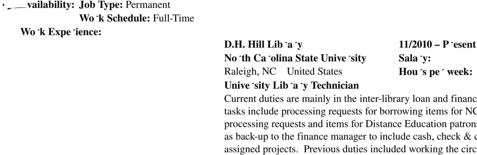

When using Import Agent to import PDFs into our repository, some PDFs are having bits of text garbled.  But the Snapshot utility works perfectly.  But since this will be a large volume of documents, the import will need to be automated, necessitating the use of Import Agent.

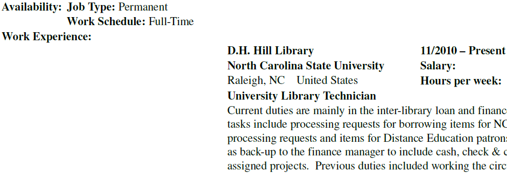

As an example, an original document may look like this:
But once imported by Import Agent it looks like this:
Import Agent has limited settings for document processing.  Since the error seems to only occur to certain text characters in the affected documents (in this document it is bolded capital As and lower case Rs), I tried both using and not using OCR, but it made no difference.
