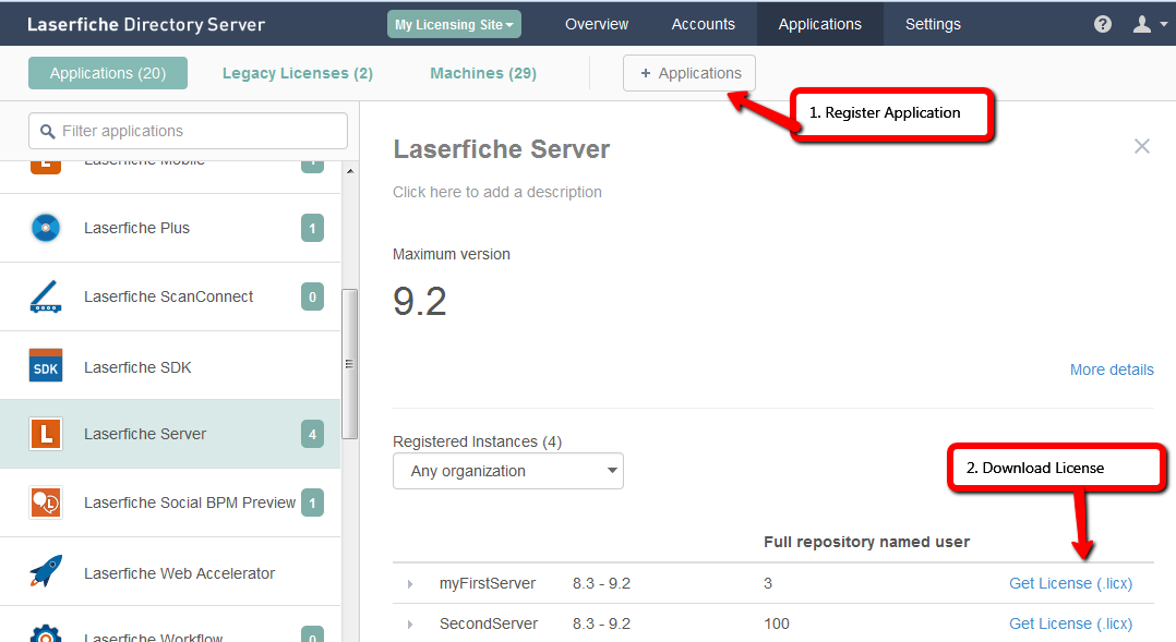

You do need to register the server first, but you can register the server ahead of time from within the Directory Server UI rather than doing it at install time:
replied on May 20, 2016
Yes, this he was what we were missing. pressing the +application button at the top. We were just being wary to do too much on there since it is their production server. As a side note, where is the best spot for information regarding how to get the users in there? is this something we can do a while as well without messing up their current stuff? a good write up on that would be helpful just to make sure this is as smooth and as quick as possible.

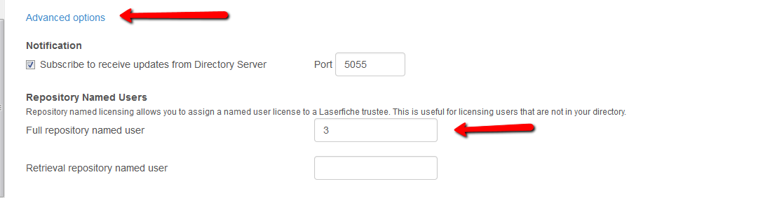

You can make changes to allocations on existing application instances by expanding the details and clicking "edit":
Then, towards the bottom on the edit or new instance page, expand the advanced options:
and add user licenses.

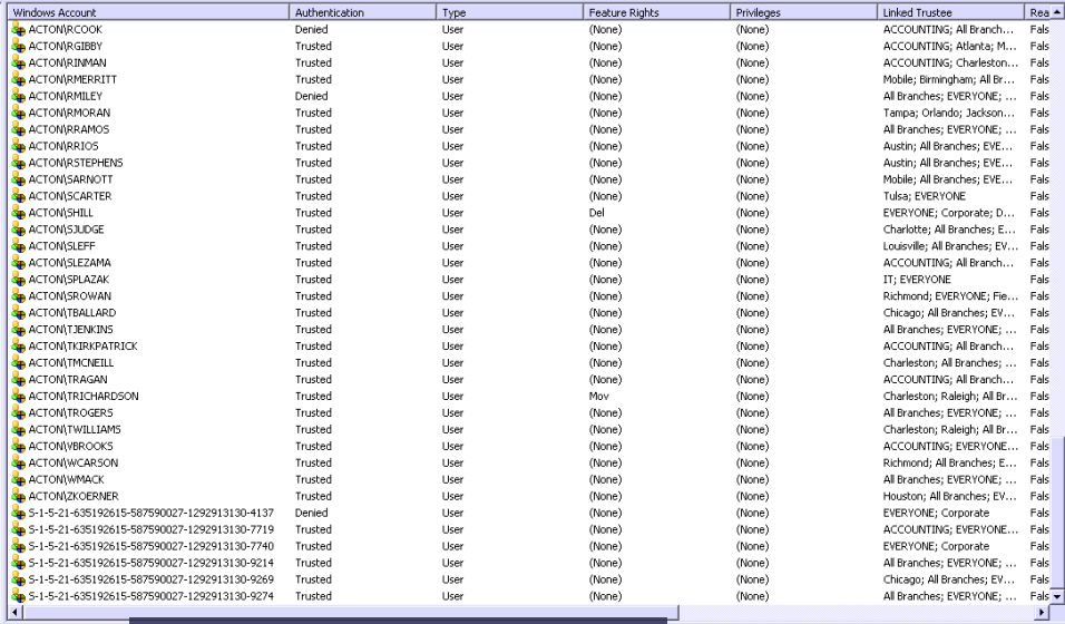

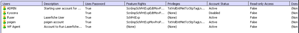

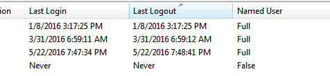

Ok, so I have gone in a manually added all of the main users into the LFDS site. the customer did not have anything setup properly in AD to port over a group. my question now is, I'm showing 116 users in LFDS but in the admin console it is showing 125 licenses being used. should those numbers essentially match? The ones I feel are in question here are the 5 bottom ones in the windows accounts and the 4 in the laserfiche users accounts (that would get me to 125.) first, do you know what those last 5 users are in the windows accounts? is this something they made or is this something laserfiche automatically makes? these are not found in the directory so if they do need to be added, how does that work? same thing for the laserfiche users that are active....Do they need to be added as well? not all of these are able to be found in AD either. another note to make would be that the only actual named user out of those 9 is the psigen laserfichce account which I did add from AD, all of the other are just active and trusted. We seem to read a lot of these white papers and confuse ourselves even more so we just want to be certain everyone and everything will have its proper access once the server is licensed.

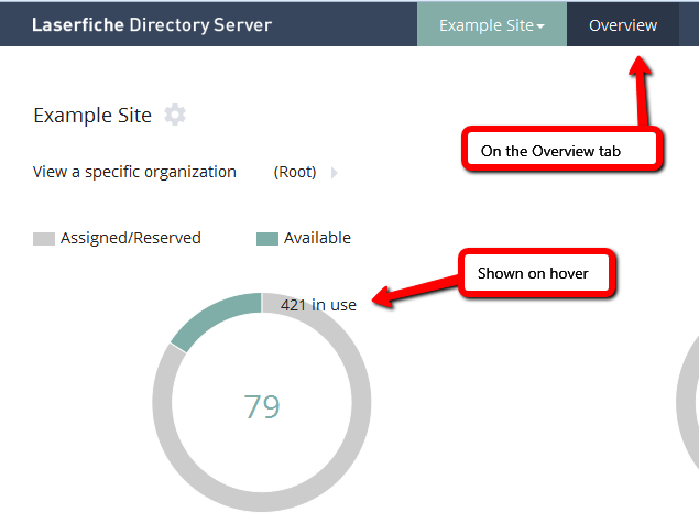

You can see the total number assigned here:
and you can get a CSV report/breakdown here:

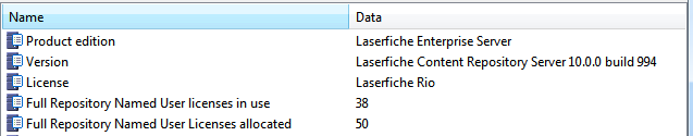

You can see the total number allocated to your Server instance and the total number assigned by selecting the server name in the admin console:
The allocated number is what corresponds to the number assigned to that instance in LFDS.
You can view (and change) the license assigned to a repository user under your repository > Users and Groups > Users. You can open the specific user properties, or scroll all the way to the right and see something like this:
You can also view (but not modify) Windows user licenses under Windows accounts.
Hopefully this helps you understand where your licenses are in use. If not, please include screenshots of where you say you see licenses in use.
2: What are these strange looking 5 users? Do I need to do anything about them?
Those are SIDs (Security Identifiers), which are a unique identifying numbers assigned to every directory user.
The users are not created by Laserfiche. You may see SIDs in your UI if you added Windows users who were later deleted from Active Directory.
If you don't have any missing users and you don't need to keep them around for the record, you can probably remove them.
