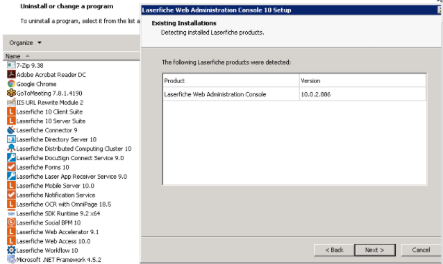

After uninstalling, I click on the setup program and it states that the Laserfiche Web Administration Console 10.0.2.886 is still detected, but it is not present in the Programs and Features.

Can you confirm that you just uninstalled update 1 and not the entire Web Administration Console 10 product? Make sure to browse to the Web Admin site after doing so. Then, upon reinstalling, confirm that you're just reinstalling update 1 from the previously linked KB article.
replied on January 19, 2016
Looks like I misunderstood and did uninstall the entire Web Administration Console 10 product. Tried to reinstall, but it is not reinstalling. Ideas?
Run the tool from https://support.microsoft.com/en-us/mats/program_install_and_uninstall and see if you can uninstall Laserfiche Web Administration Console 10 from there. Once the product is completely uninstalled, then reinstall using the setup files that you have.
At this point, you should be back to having Web Admin 10 Update 1 installed and the issue occurring. Then follow the steps in the initial reply where you only uninstall Update 1, visit the Web Admin Console site in a web browser, and then reinstall Update 1.
