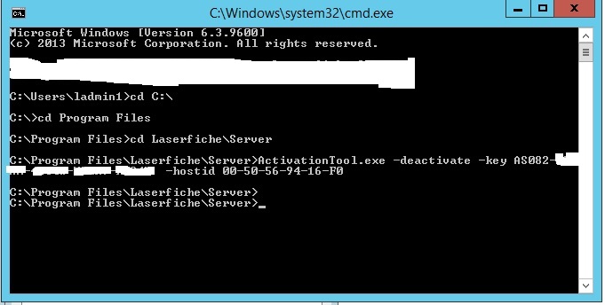

Hi all,
I wish to know how to deactivate the demo license on a test environment. I have used "cmd" to do it. However, there is no indication that the license has been deactivated. Please find attached screenshot of the command.
Thanks to advise how to deactivate it.
Kind Regards,
Sheila
replied on January 18, 2016
you can try by reactivate it and see if you have an error,
but it should have worked if you have not receive any error message
hello Sheila
1. to know your license deactivated successful login to laserfiche support site & check the Server License      Remaining Activation Column from the Current Products Table.
2. uninstall the laserfiche server module which will deactivate product automatically .
Note: Make sure Internet connectivity is available during deactivation time.
Thank You.
Hi Sheila,
If the demo kit is still activated after running that command, try re-running the command with the -fingerprint flag and the hardware fingerprint of the machine where the product you'd like to deactivate is installed. Check this explicitly even if the machine you are running this command on is in fact the machine with the installation in question.
Note that as Mazahir has said, if you already have access to the installation machine, simply uninstalling will automatically deactivate the license. The manual deactivation process was intended for situations where access to the installation was impossible due to hardware wipes, broken machines, etc.
If deactivations continue to fail, open a support case and we can troubleshoot in greater detail.
Hope this helps!
