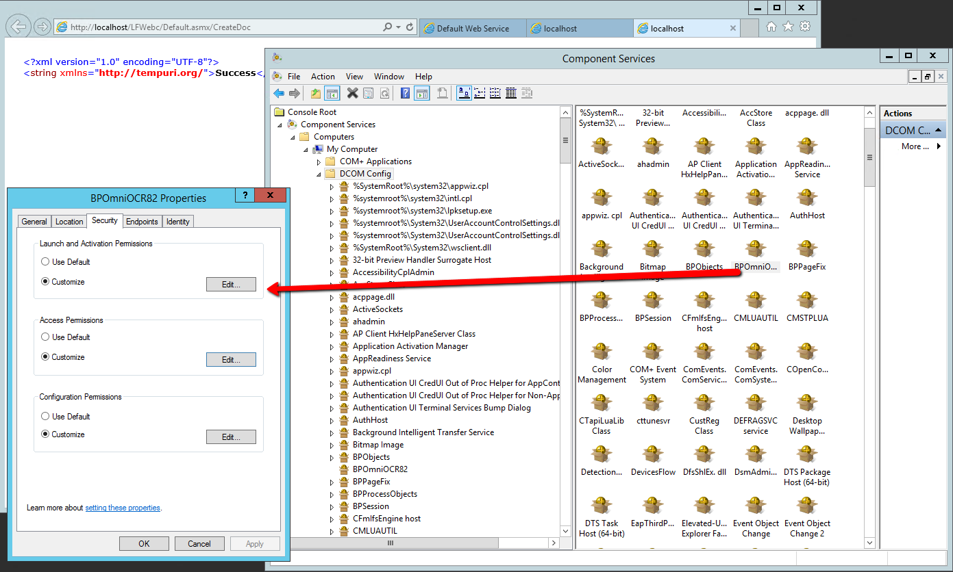

I tried the sample project on a test machine and experienced the same problem. I fixed it by granting DCOM launch & activation permissions to the BPOmniOCR82 and LFOMNIOCR. You can do this through the Component Services mmc snapin:
I granted access to the Everyone group but you might want to be more restrictive. It started working after i added permissions to both of these controls (and reset iis).

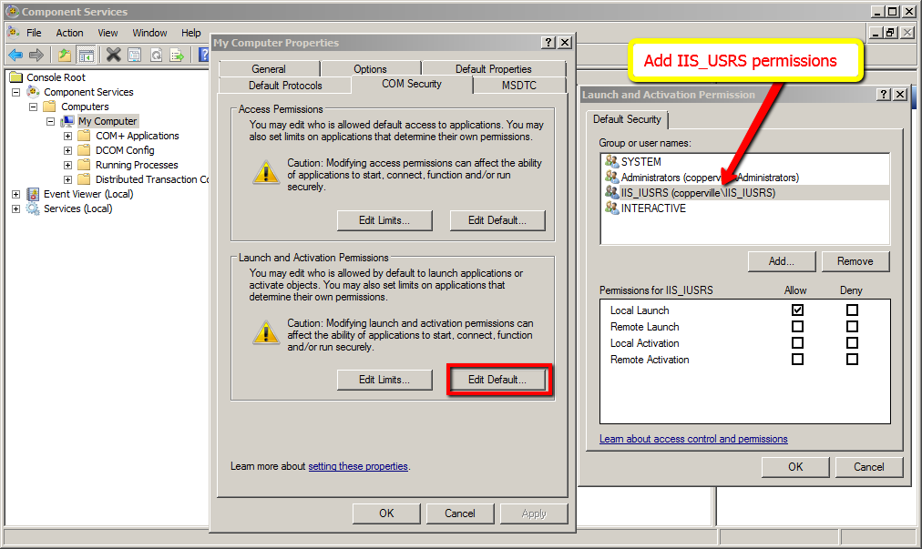

I added the same permissions for the Everyone group as well as the IUSR user and made sure the 'Enable Distributed COM on this computer' was checked; however, I still get the same error after restarting IIS and rebooting. I also gave Everyone full permissions in the COM Security tab's 'Access Permissions' and 'Launch and Activation Permissions' limits. I also tried giving Everyone permissions to the OmniOCRWrapper82 DCOM object. Is there anything else I may need to enable?
replied on January 5, 2016
Check the System event log for DistributedCOM errors, my log is filled with errors from when I was attempting to configure the security. When the log mentions a CLSID that is a guid (e.g. {25CA57CC-AB34-4221-95AF-99736B5B84AD}) you can search regedit for that string to find which component it is.

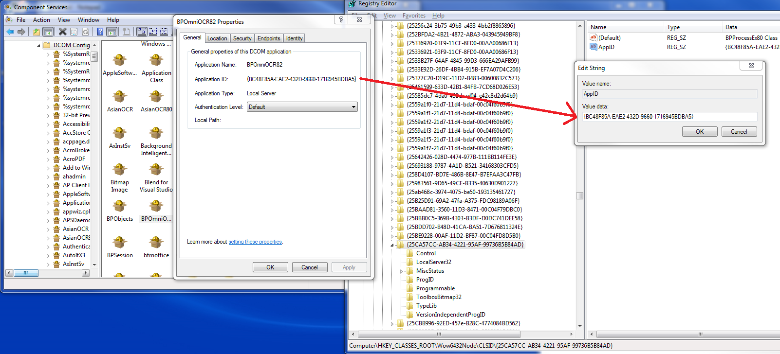

Okay, here was the error I was getting in the System Log:
The machine-default permission settings do not grant Local Activation permission for the COM Server application with CLSID
and APPID
Unavailable
to the user IIS APPPOOL\ASP.NET v4.0 SID (S-1-5-82-794271414-2547205055-1060673776-2579641347-304524694) from address LocalHost (Using LRPC). This security permission can be modified using the Component Services administrative tool.
I saw that the CLSID in the registry did not have an AppID registered with it, which I assume meant it wasn't using the permissions specified in the Component Services. So I added the AppID for the BPOmniOCR82 DCOM Config {BC48F85A-EAE2-432D-9660-1716945BDBA5} as the AppID in the registry for the CLSID {25CA57CC-AB34-4221-95AF-99736B5B84AD} reporting the above error.
That seems to be working now. I tested on a second machine and had to open the permissions as you outlined earlier and also set this registry key.  Do you think something is failing during the SDK installation?
