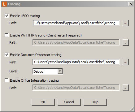

replied on August 31, 2015
Turn on LFSO & DocumentProcessor tracing in the 9.1 client (from Help->About->Tracing), then try reproducing the problem. This should produce more verbose logs.
