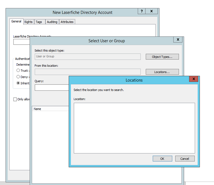

Can't find directory server in locations from Admin Console
asked on December 17, 2015 • Show version history
I've created a directory user in LFDS but when I got into the admin console I don't see a location (LFDS) to get the user from. Has anyone seen this issue?

replied on December 18, 2015
Yes this was an upgrade, from 9.2.1. And I am trying to add a Laserfiche User that I've created in LFDS.
This is actually the second customer that I've upgraded with the same issue. Internally our Laserfiche was upgraded and works fine though.

replied on December 21, 2015
I actually had this issue as well, and this fixed that particular issue but not the one I'm asking here unfortunately. I'm thinking it might be a communication issue. What ports need to be open for Admin console/laserfiche server to talk with LFDS? If there are any besides 5048/5049
