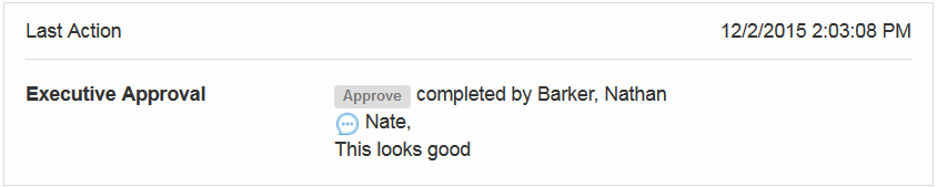

I have a form that goes through multiple approval processes.  When a task participant uses the 'Enter' key to enter a line break (< br >) it causes an error when the next participant tries to approve/reject the submission.
This also returns an error in the Event Viewer, but there is no way to prevent the user from doing this...  Here is the event log:
Message: A potentially dangerous Request.Form value was detected from the client (Field70="Nate,
<br>This looks good").
Here is a jing of the error that occurs.
http://screencast.com/t/b5yUbKI4MIID
Any help is much apprecaited,  this is causing major errors and preventing our process from moving forward.
Thanks,
Nate

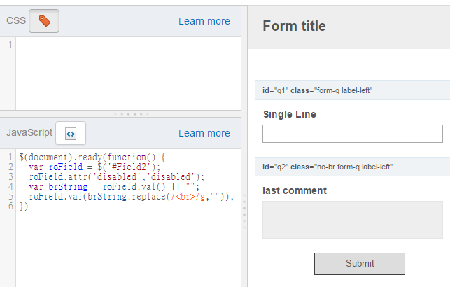

Since the issue has been fixed in Forms 10, you can use following javascript to get rid of "<br>" tags in your field with {dataset\comments} token so submission won't be blocked.
  var roField = $('#Field2');
  roField.attr('disabled','disabled');
  var brString = roField.val() || "";
  roField.val(brString.replace(/<br>/g,""));
  1. Replace "#Field2" with the field id that has {dataset\comments} token, and
  2. Please make sure that field (field with {dataset\comments}) is not read-only (the script will make the field read-only so don't worry about that)
after that, the <br> tags will be removed from that field, and submission should work.

Note: the comments on the first form (with line break) are filled into a text area field within the 2nd form using the token {dataset\comments}.  It's odd because the  text area should allow line breaks, but for whatever reason it's putting a <br>

replied on December 7, 2015
Thanks Lifei, this did the trick!
