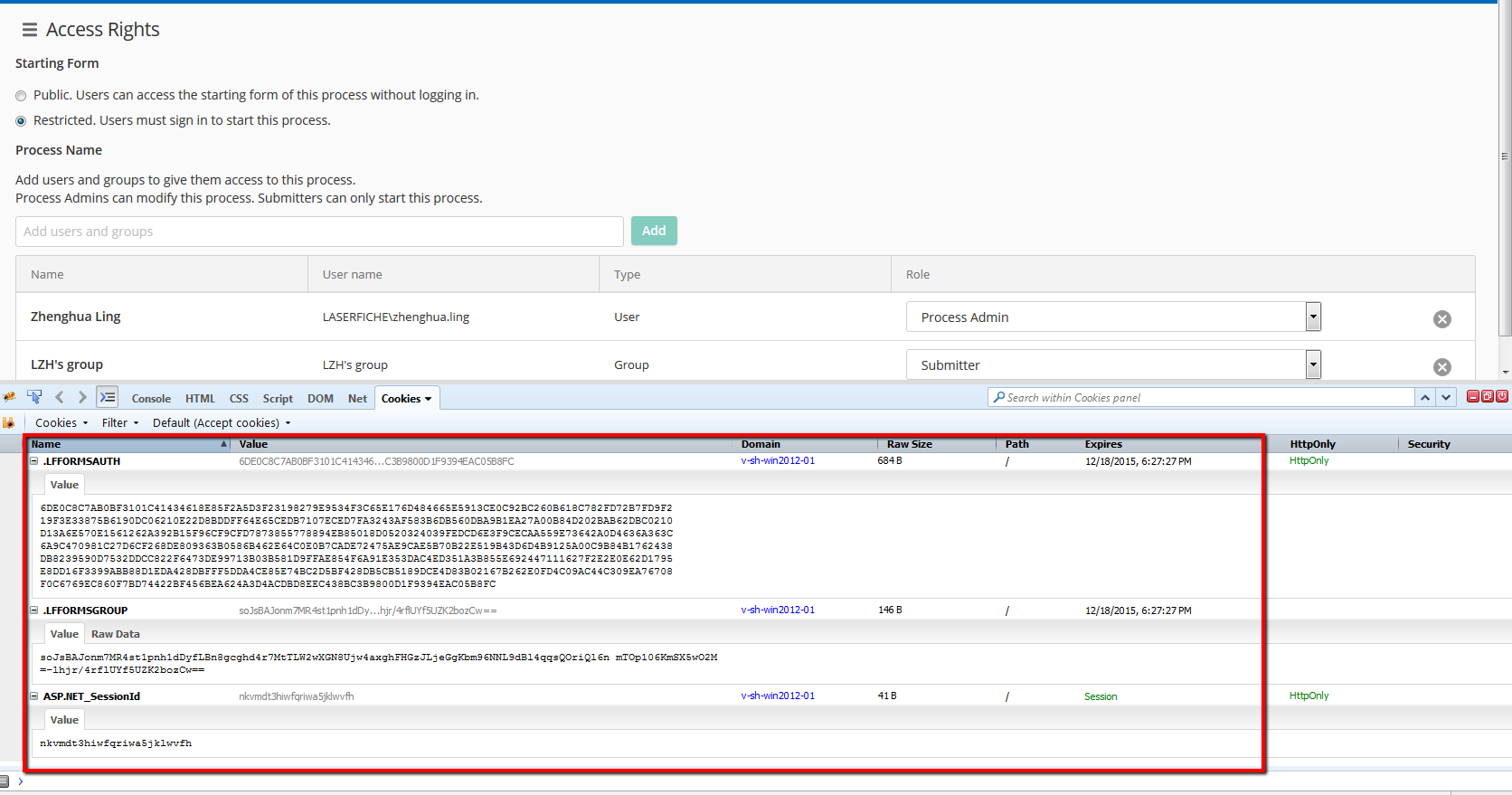

The issue may caused by the cookies. Can you help me record some screenshots in the following situations?
  • User login when remember me and can’t access the form.
  • Log out and manually log back, access the form successfully.
  • The user can’t access to the form again the next day
In the screenshots, please show the Value and Expires/Max-Age of the 3 cookies:  .LFFORMSGROUP( important),  .LFFORMSAUTH,  ASP.NET_SessionId.
Firefox: Right click the mouse>Inspect element with Firebug (need to install Firebug first)> cookies > your form site.  (can show value clear than Chrome)
Chrome: Right click the mouse >Inspect element> resources > cookies> your form site.

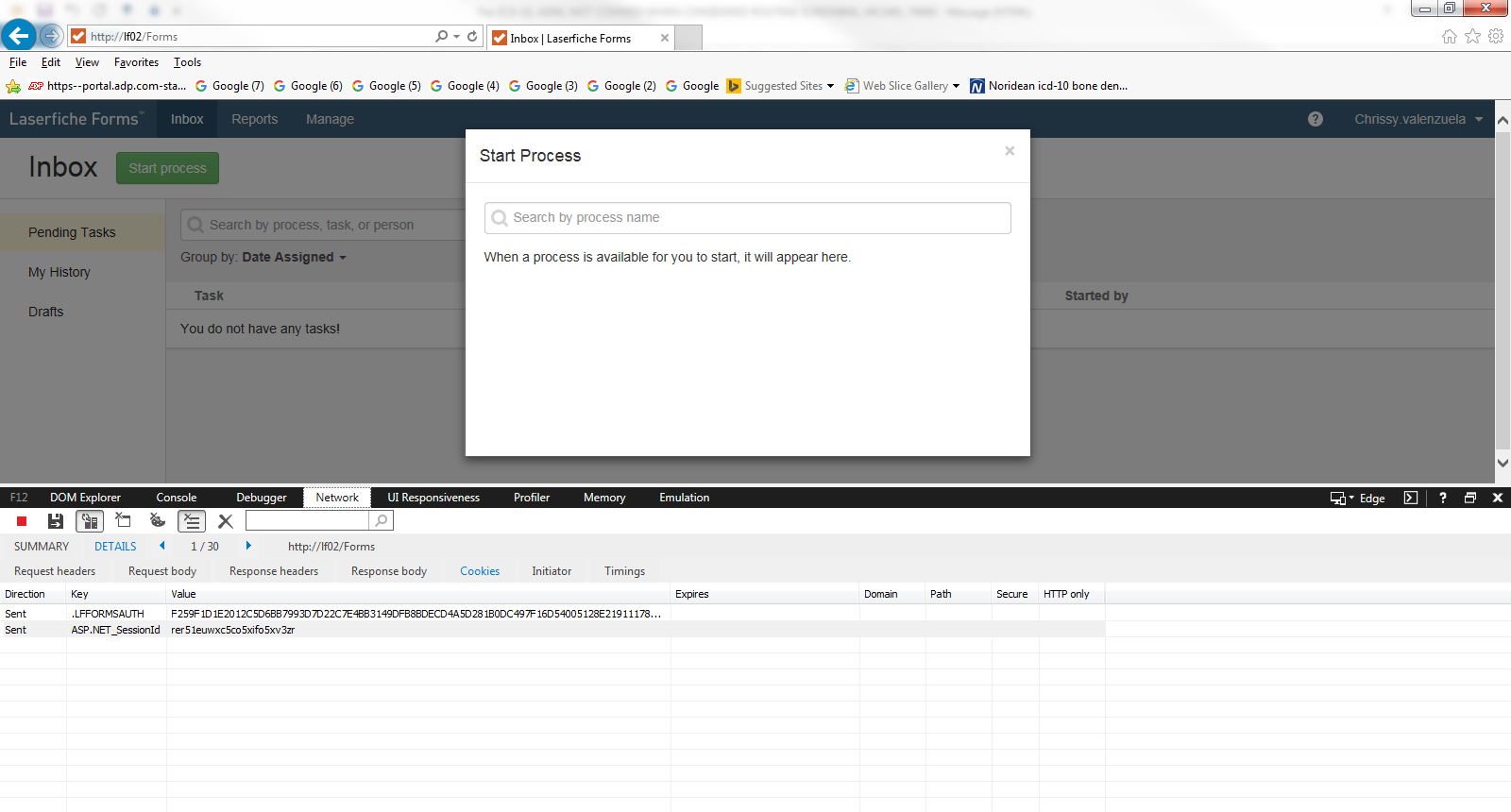

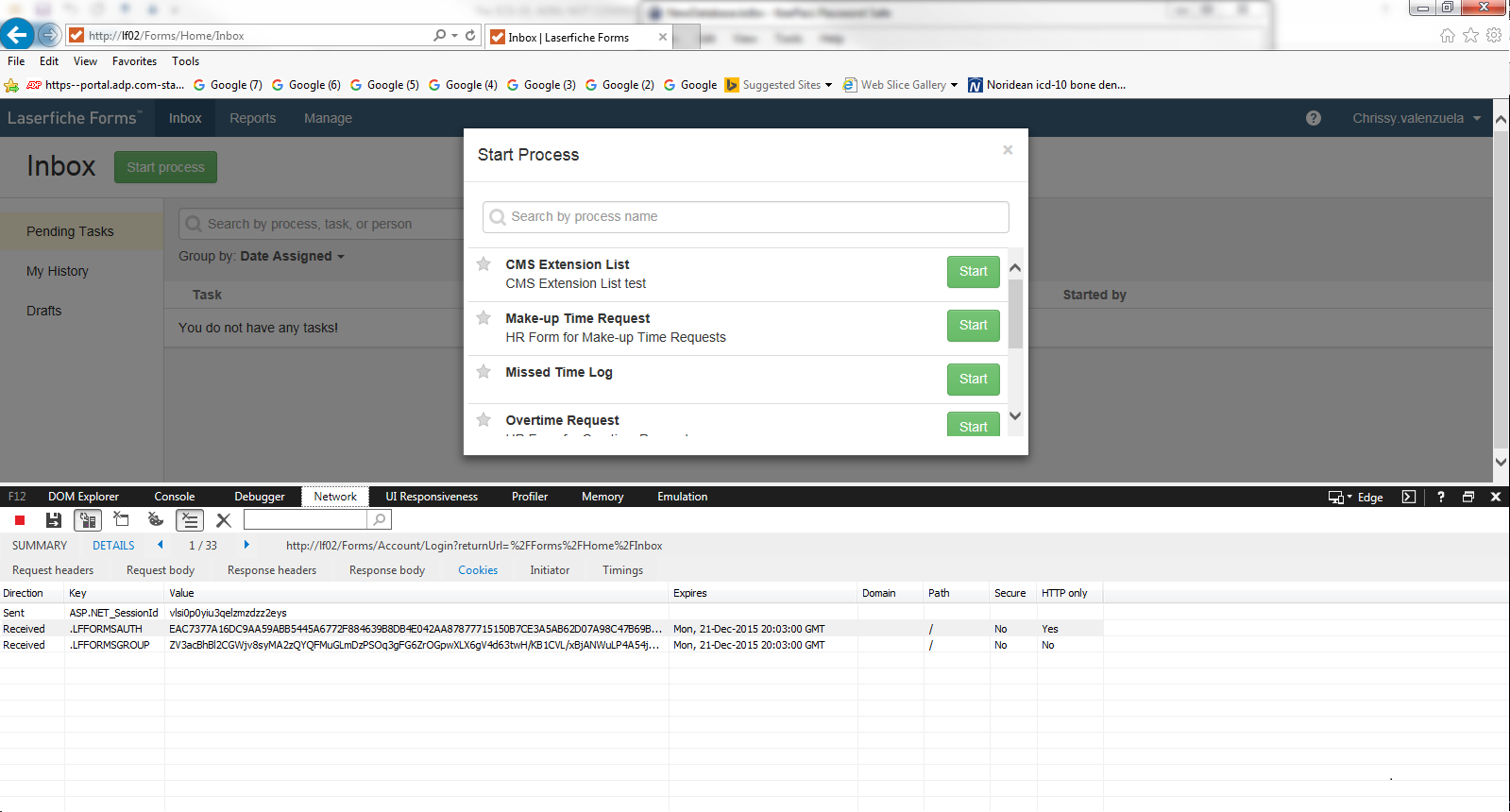

replied on December 7, 2015 • Show version history
Here is the cookie information collected from Internet Explorer before and after logging out/in.

Cookie .LFFORMSGROUP is missing in the first screenshot. I know one case that also has no .LFFORMSGROUP cookie. It happens when you use domain\yourname@domain.com to login.  If that’s the case, please use domain\yourname to login.
If you log as domain\yourname and the issue still exists, when the user can’t inherit from the group, check whether the user name is in the “domain\yourname@domain.com” format from account page.
