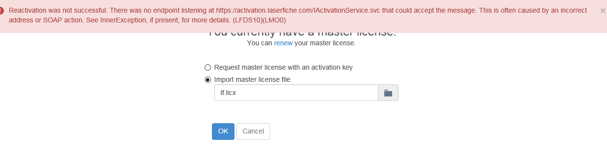

I am trying to renew the license in the directory service website but we need to do it offline.
Our vendor send us a license file to add but when I try to renew it it is showing as if is trying to contact the Laserfiche activation webservice.
See attached screenshot.
Any idea how to activate offline with a license file?
Thanks
Gian

Adding some more info, if I click on Renew this error shows up.
If instead I click on OK the loading icon appears but doesn't do anything. I let it run for over 30 minutes.
Thanks
Gian

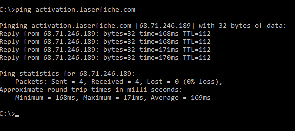

Sounds like it can't contact the licensing site. Check to see if you can ping activation.laserfiche.com.
There will likely be a firewall blocking this.
Cheers!
replied on October 14, 2015
Hi Chris,
Yes exactly, there is no ping but because the server needs to remain offline.
That is why I need a way of activating with a license file instead of the license key.
Thanks
Gian

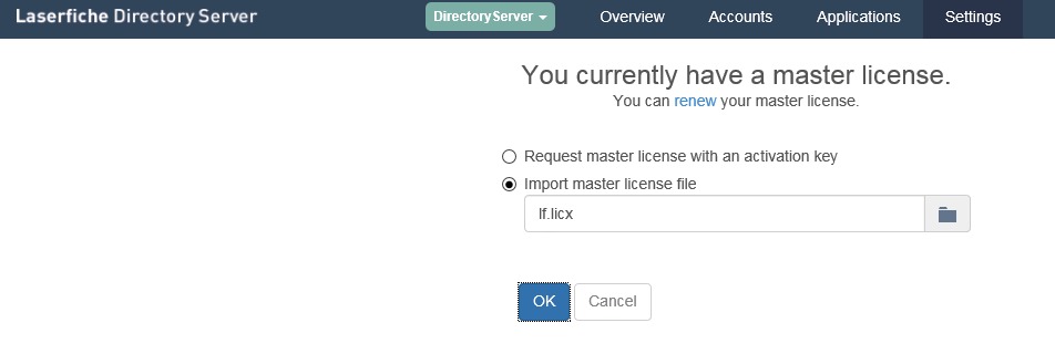

Hi Gian,
Interesting..... In my testing here, I click the OK button at this point, and nothing happens!
Although I'm using Laserfiche Directory Server Version 9.2.0.548. Will upgrade it now to 9.2.1.
Might be best if we raise a support case? What do you think?
Cheers!
This was fixed by following Chris answer.
Went to each server instance, clicked edit and then save.
After that I added the license and it worked
