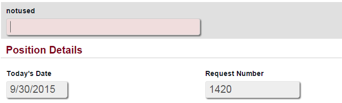

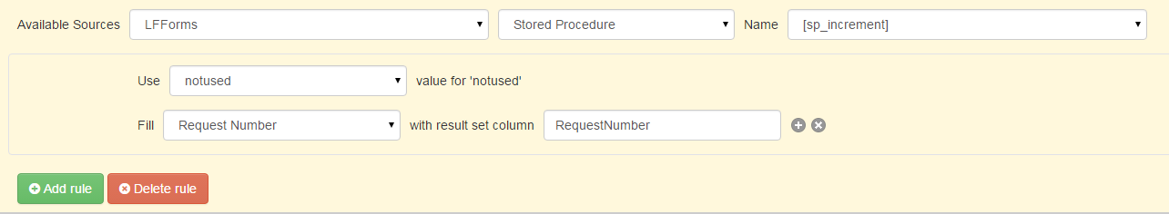

I am looking to achieve similar results to this post  but I cannot get my SQL statement to function properly.  Per Robert's instruction, I am creating a IF clause in my SQL Statement, but for whatever reason it is triggering when the form loads AND when the field notused is changed.  Below is my sql statement and screenshots from my form.  Any help is much appreciated!

Hi Nate,  sorry about the long delay in responding.    I think I see a couple of problems with your stored procedure.
'IF @notused is NOT NULL' is always going to be true because the value is blank.
So change that to IF @notused != '' and you will have better luck.
Also  '@notused varchar(50) output' doesn't seem right because the 'notused' is supposed to be input and not output.  Your picture in lookup configuration shows 'notused' as input so perhaps you fixed that part  already before you uploaded the picture.
