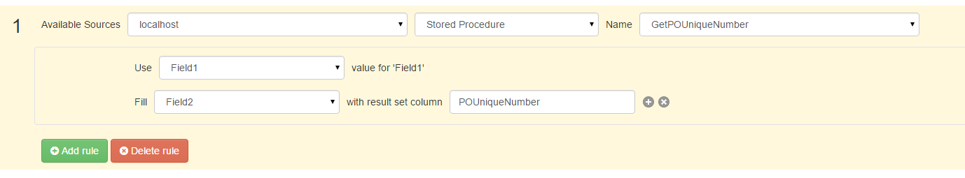

replied on January 21, 2016
Sorry to restart an old post but I am with Jen.  It would be good to have an example of the stored procedure to only run when a value is not blank...
I have read a few posts on the forum but cannot patch it all together...
So if I have two fields q1 and q2, what would be the stored procedure to fill q2 when q1 is filled in;
My stored procedure looks like;
USE [DynamicTable]
GO
/****** Object:  StoredProcedure [dbo].[GetPOUniqueNumber]    Script Date: 22/01/2016 10:31:40 AM ******/
SET ANSI_NULLS ON
GO
SET QUOTED_IDENTIFIER ON
GO
ALTER PROCEDURE [dbo].[GetPOUniqueNumber]
@q1 varchar(50)
AS
IF @q1 IS NOT NULL
BEGIN
SET NOCOUNT ON;
INSERT INTO [dbo].[POUniqueNumbers]
([NewNo])
VALUES
(1)
SELECT SCOPE_IDENTITY() AS POUniqueNumber
END
Lookup Rule Snapshot
The number fills on form load only.  So obviously I have something wrong in the Stored Procedure..... can anyone help please?
Cheers
Ross
