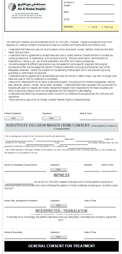

i need sugession how i can design the same paper forms look & feel with laserfiche Forms.
i am attaching paper forms sample.
Thank you.

Hey Mazahir,
I took a try at this and came up with the following image.  Email me at barkern@protrans.com if you want me to send you the XML.  Otherwise, good luck!

Hey Mazahir,
You'll want to use a combination of CSS and Javascript to get the form to look like your paper form.  Not sure it's possible to make the form look 100% the same, but you can definitely make it look pretty close.  The one area you may have issues with is the 'Substitute Decision Maker (SDM) Consent' - To get the fields to align properly and fit within the text, you'll want to use the code found (Here).  Other than that, you can place the Name, Signature, and Date fields in line by using CSS to align them properly.  An example would look like
#q1, #q2, #q3 {display: inline-block; width: 33%; vertical-align: top;}
Replace the #q1 with your field numbers.  This should get you started in the right direction.
Nate

replied on September 26, 2015
Hi, Mazahir.
Feel free to email me at sheila@ecofilecorp.com. I'll have to get authorization from one of my clients to share their form since they paid for its development.
In looking at your form, it shouldn't be too difficult to replicate. If you use what Nate said above, and use a float and some other CSS, you should be able to recreate this form. The float would be used for the top section, along with a double-lined border. And it looks like the rest could be done with sections and Nate's suggestion of Custom HTML controls and moving fields into them (courtesy of Michael Mathys).

replied on September 27, 2015
Hey Mazahir,
