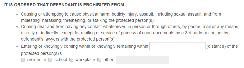

I've seen some questions on here regarding custom HTML input boxes not saving values.  I believe we've found a very easy way to make this a reality.  See the series of screenshots below (excerpt of Domestic No-Contact Order):

The end result when filling out this form is:

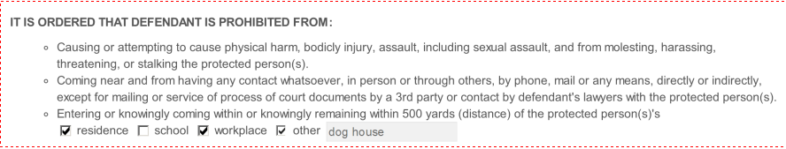

And the final result when storing the form is:

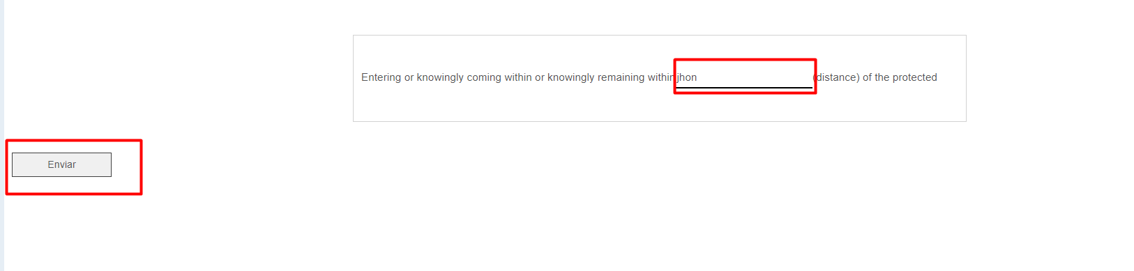

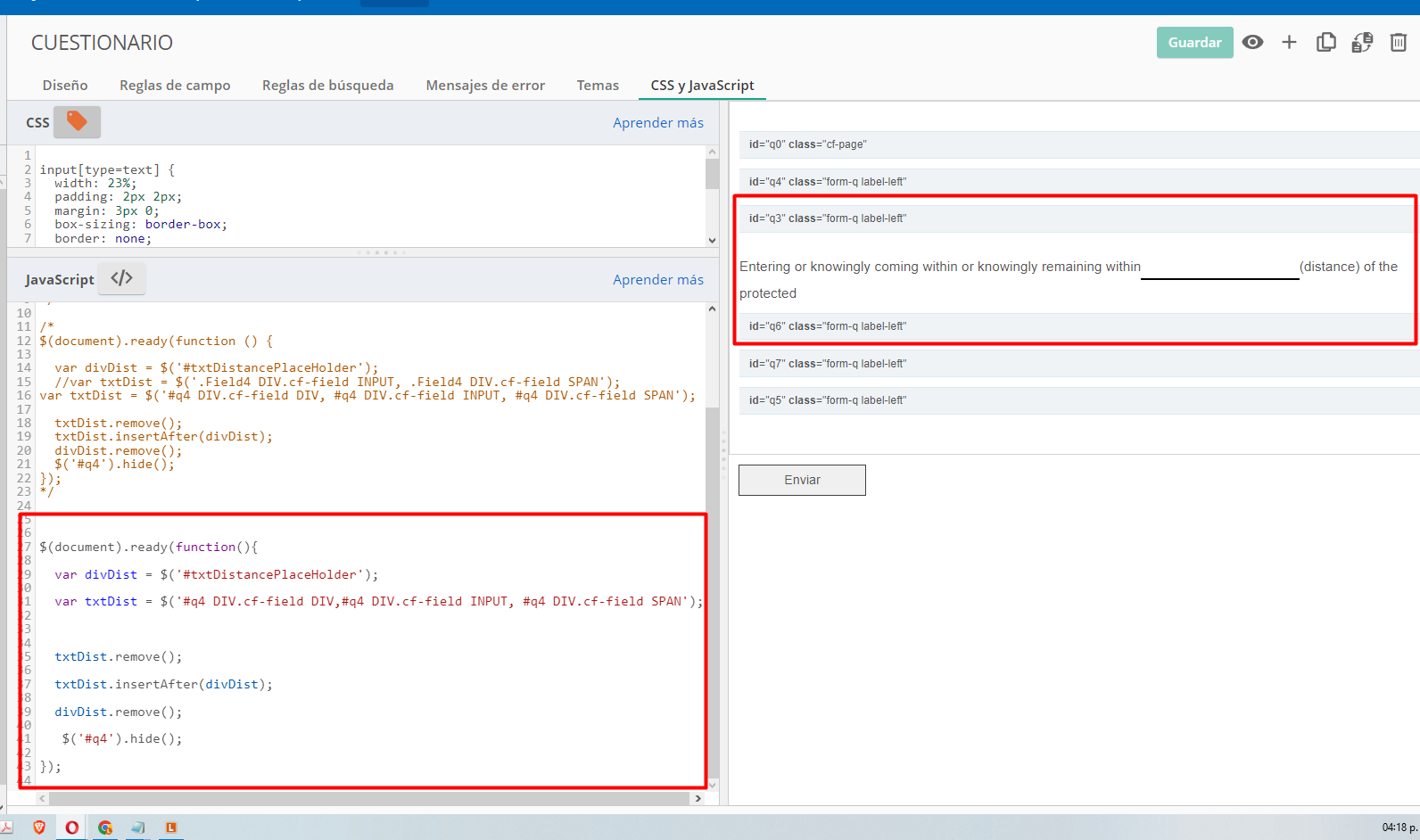

replied on May 11, 2023

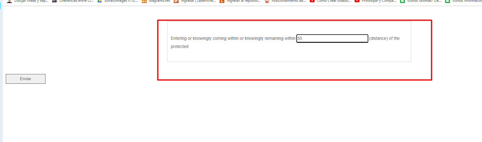

I replicated the same exercise for laserfiche 11 but it is not function
do you have some ideas for this my format is pdf or tiff?

replied on May 12, 2023 • Show version history

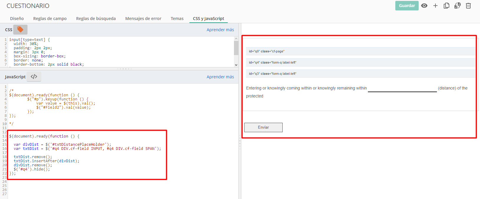

If you follow the link I posted you can see my example, that has been tested in 11 and works. The difference I spotted between our two code snips is that I have three parts(DIV, INPUT and SPAN) I'm grabbing instead of two (INPUT and SPAN).
  //Search for DIV, INPUT or SPAN, SPAN is used for display
  var txtFieldOne = $('.dcFiscalYearOne DIV.cf-field DIV, .dcFiscalYearOne DIV.cf-field INPUT, .dcFiscalYearOne DIV.cf-field SPAN');
link to my Laserfiche Answers post: https://answers.laserfiche.com/questions/180418/Is-there-a-way-to-insert-an-input-field-into-a-table-header
EDIT: the code snip above is from another form I did the same thing on so that is why the variable name is different.
replied on May 16, 2023

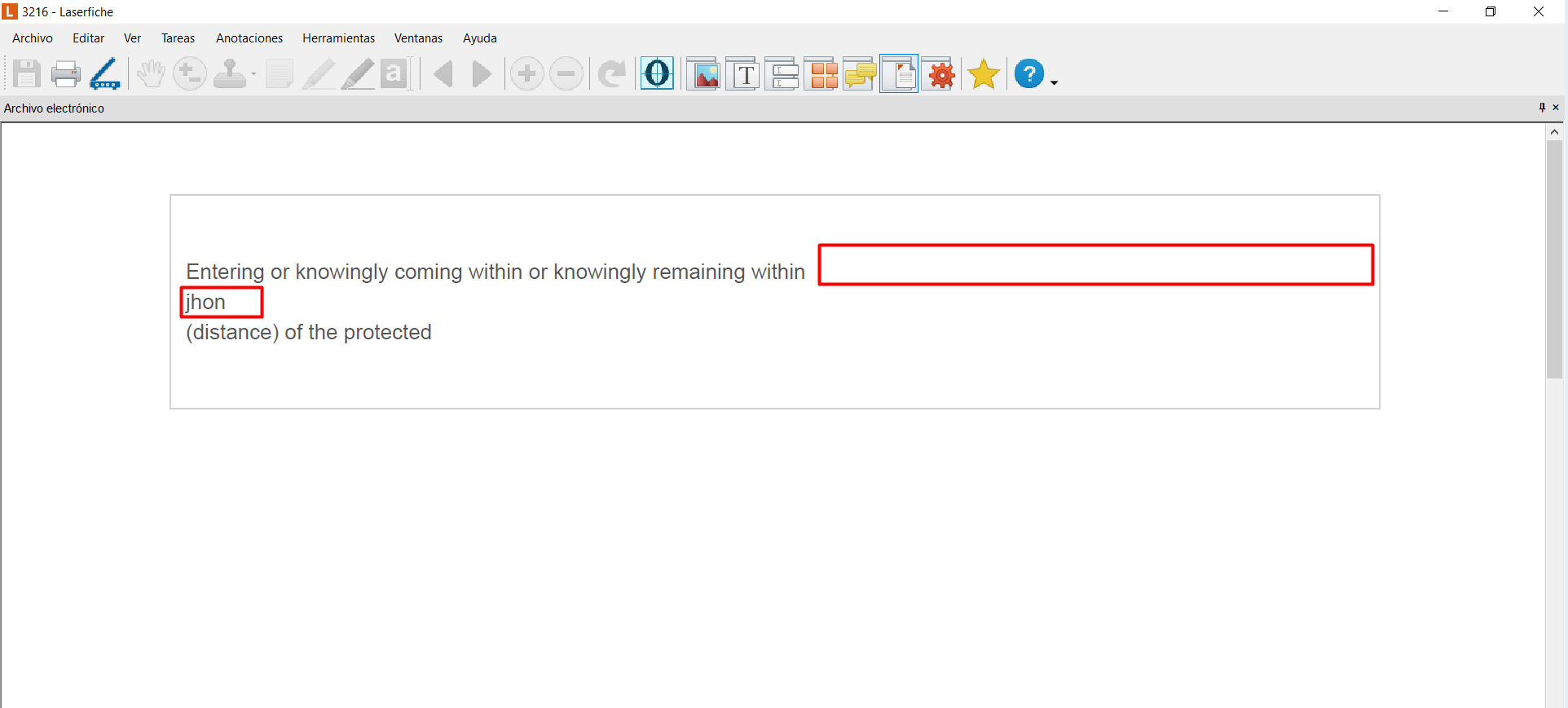

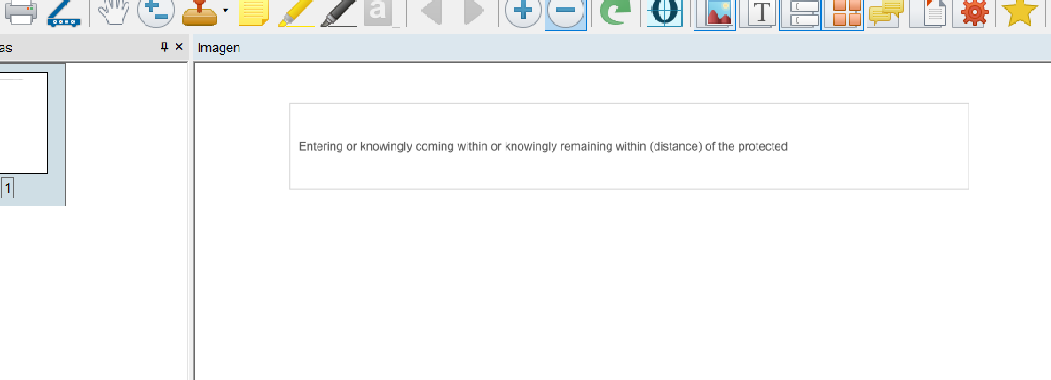

ok, yes it works, but i have another problem, if you use DIV when you generate the PDF OR TIFF file it generates a space , like this example.
any solution?? please
replied on May 17, 2023
What does you HTML and CSS look like for that DIV. I suspect the issue is there.  Maybe a width setting.
