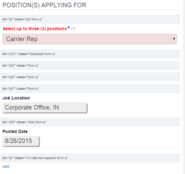

I am looking to accomplish the same result found Here but the main difference is that my use case is within a COLLECTION and for whatever reason, that is acting different than a table.  Below is the code I am using for a drop-down list with job as the CSS class.
The issue I am running into, is that when the form is submitted, the values are not passed to my template field, then when the saved PDF is viewed, the Field is not shown either.
Code:
