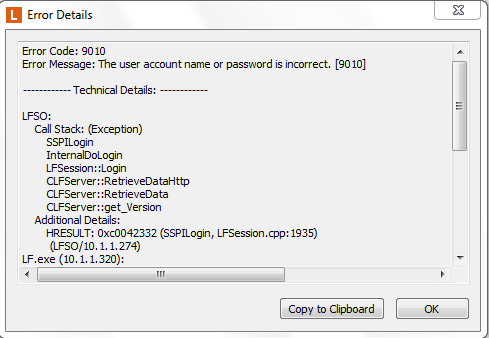

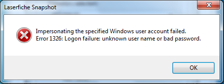

  2. We have upgraded to version 10 since the initial question was started. Previously on version 9 we could get Snapshot to work, but not the LF Desktop Client. Now on 10, neither of them work. Both Snapshot and the Client gives the error below:
Client
Snapshot
3. As for not replicating AD, the Active Directory is replicated but because this is a Global Continuity site, none of the Workstations are joined to the Domain. So users are not logging in with their AD accounts on the PC, they login as a Local Administrator account, that is the same for all, and then when accessing the different applications, they enter their AD credentials and which allows them to gain access to the different applications.

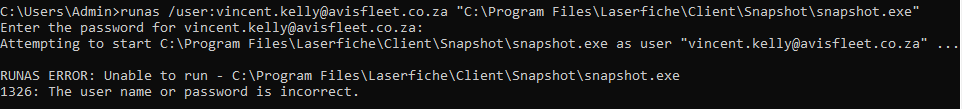

replied on March 20, 2018
Hi Robert,
We are back on this topic and I have tried the run as option you suggested. Unfortunately it is still unsuccessful. Still gives an error that the username or password is incorrect.
any further suggestions?
